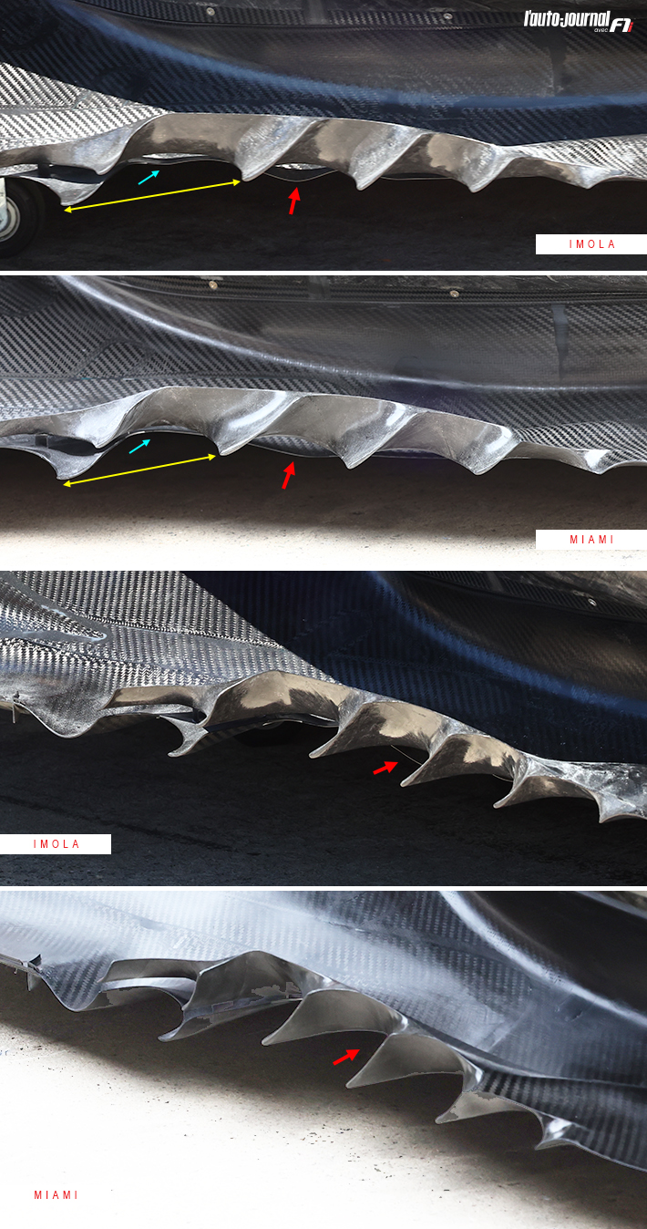

Very interesting shape here. Higher floor on the outer part of the tunnel?

Yes, same as last year. There is strong interaction with multiple flow structures in that area, while peak local downforce on the lower section of the throat is positioned inward and towards the boat section - my guess to make it more "roubst" in yaw and adverse conditions, ie not too susceptible to downforce loss in those conditions
