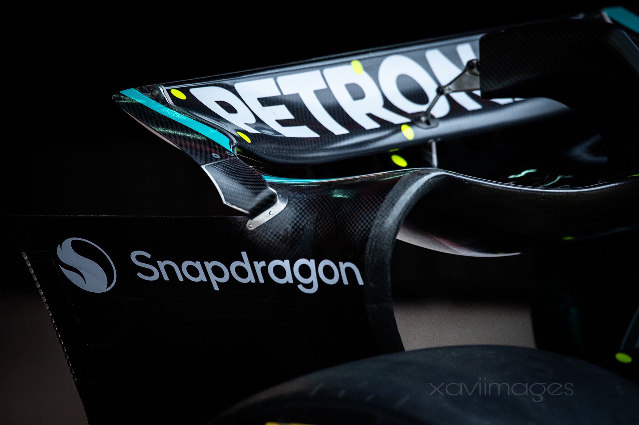

Detailed shot of Merc's rear wing, taken at the imola GP
Re: Mercedes W15
Out-washing rear wings. You would think it would be bad to out-wash higher than the side plates, but in this generation it seems an out-washing upper wing flap is good?
1120
Re: Mercedes W15
PlatinumZealot wrote: ↑
11 Jun 2024, 10:21
There is a lot of discussion about the rear wing endplate corner, and huge diversity in ideas across the grid.
You can be reducing junction losses, depowering/powering the tip vortex, increasing horizontal expansion via outwash
This video should give a good indication of what changes lead to what outcomes in this region
