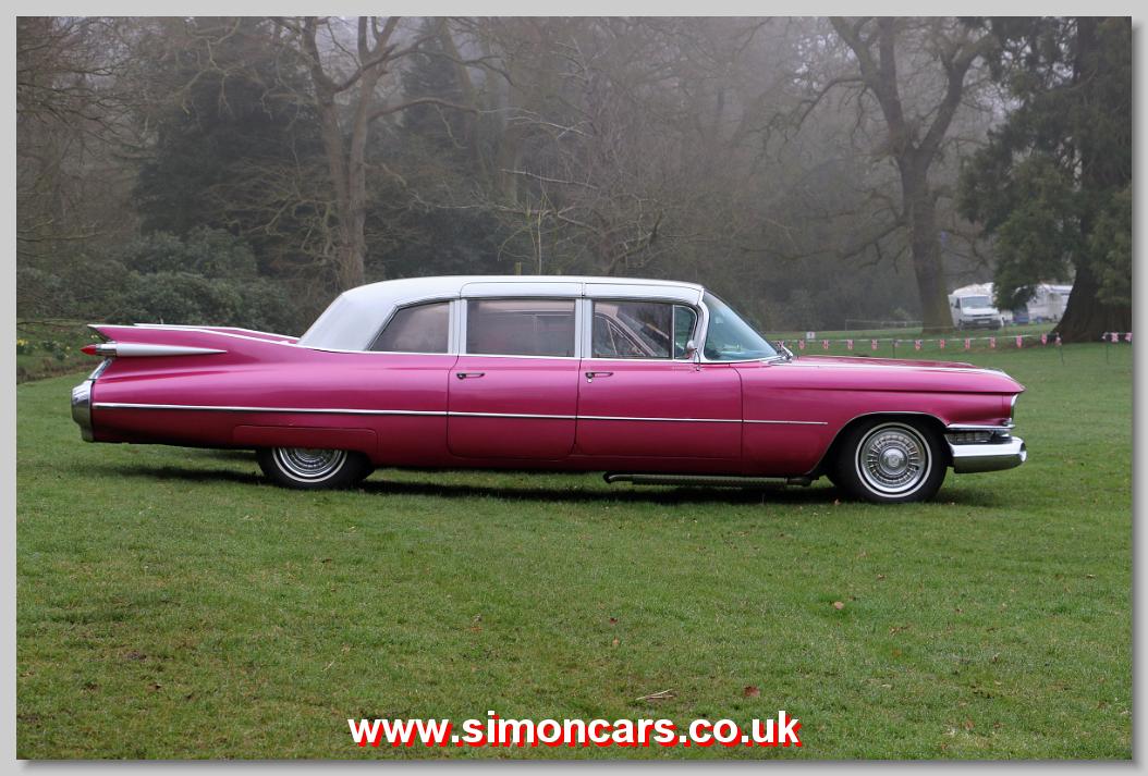

Vehicles with same wheelbase as 2018 Mercedes F1 car (+/- 1 inch):
An American full-size crew-cab pickup-
A 1959 Cadillac Fleetwood extended wheelbase-
More topical?, a 1968 Mercedes-Benz 600 Pullman Limousine-
These-
