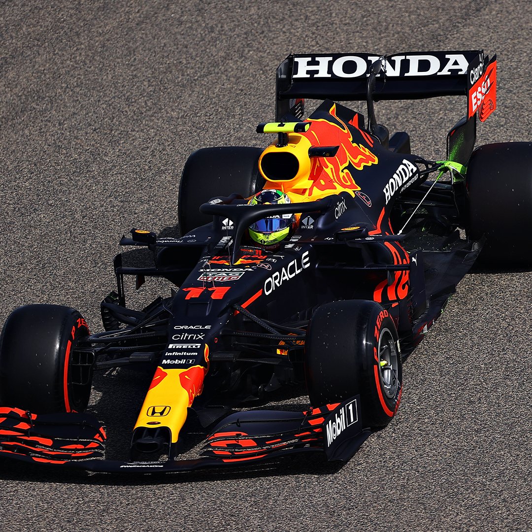

This is a good segue into the current car and the difficulties brought by the new regulations. Rear tire squirt is a big issue.
Going back to last year, the slots increased the pressure on the face of the tire, but when the car is in yaw that pressure also shifted, which meant the pressure difference on the outboard side of the tire was greater than the inboard, because the brake ducts were also increasing the airflow outside the tire.
The static pressure is actually higher because all the airflow is moving outboard, so the airflow that's left is stuck recirculating trying to find the lowest pressure it can fill. The body work around the diffuser tries to delay that static high pressure air from getting to the low pressure zone increasing the pressure difference.
What the rules have done is hurt the ability to send the rear tire wake outboard. Instead the floor has to interact with the tire squirt directly. The tumbling air that spills off the high pressure face of the tire rushes to fill the low pressure void behind the tire.
Going to the alignment point, the way air spills off the tire will in fact be affected by alignment, and camber angle, which changes as the rake angle changes, as the car is loaded at speed. That's not all, the way the tire deforms also plays a big part in how airflow spills off the tire. Once teams understand that better, it could take a few weeks or months to start putting that understanding to optimize their designs.
Knowing all of this it will be interesting to see how RB16B is developed going forward.
This goes back to my earlier point, if you want to reduce the turbulence on the inboard side of the tire, you either increase the pressure difference on the outboard side(harder to do because of the regulations), or you lower the pressure difference inboard, by raising the static pressure behind the rear tire, right where it's moving away from the ground.
Think about how a wheel well reduces tire turbulence, and reduces drag? The air inside the wheel well is higher pressure both ahead of, and behind of the tire, so the pressure difference between the face and the transition to the low pressure region behind the tire is greatly diminished. You can't stop airflow from interacting with the tire, but you can limit its effect. By encapsulating the tire in a high pressure zone you effectively reduce turbulence by reducing the pressure difference the tire experiences. Notice I said you reduce, not eliminate, you cannot eliminate air.

The front wing and bargeboard exemplify this beautifully. The high pressure air on the face of the front wing reduces the pressure that reaches the face of the front tire. Nicely managed to go around the tire, while the bargeboards raise the pressure on the trailing edge wake of the tire reducing it's overall turbulence in one fell swoop. I would wager that the front tires are effectively managed as if the cars had front fenders with wide open louvers.
