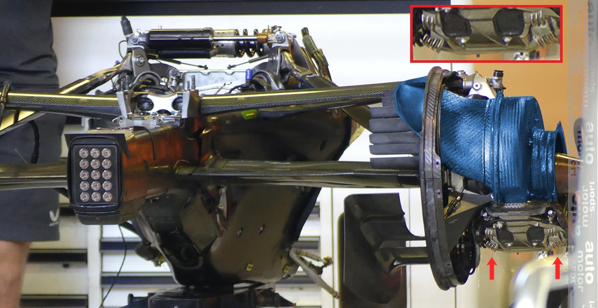

A nice duct that collects hot air from the discs exits & vent it / let it be sucked by the low pressure area behind those winglets.
Brake caliper has small fins like a heatsink.
