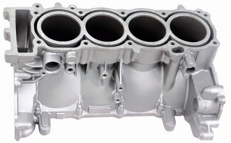

Made from billet cylinder block/case:
How is cylinder cooling accomplished?
Brian
wuzak
wuzak
475
Joined: 30 Aug 2011, 03:26
Re: Renault V6 Power Unit
hardingfv32 wrote:Made from billet cylinder block/case:
Brian
Wet liners.
http://1.bp.blogspot.com/-zv72DKPc8P8/U ... linder.GIF
http://www.renault4.co.uk/gordini-engin ... -large.jpg

Wuzak, is that known fact or a working theory?
Personally, I have not seen an "eye witness account" to confirm the use of wet liners.
To confirm that a block/crankcase is machined all over requires seeing/knowing the detailed arrangement inside the engine but that does not mean you have to share what you saw - and there may be good reasons not to.

Brian Coat wrote:Wuzak, is that known fact or a working theory?
I was just responding to how a machined from billet block could have cooling achieved. It seemed like the obvious answer to me.

The mid-mounted arrangements you gave as examples may well struggle with structural stiffness at such high peak cylinder pressures.
However *top* mounted wet liners have been used on some common rail diesels (high pcp) so the idea of using a wet liner is not implausible.
Edit: Over on the Merc PU thread, I posted another plausible theory for how you could achieve a solid-machined crankcase. Head with integral bore.
