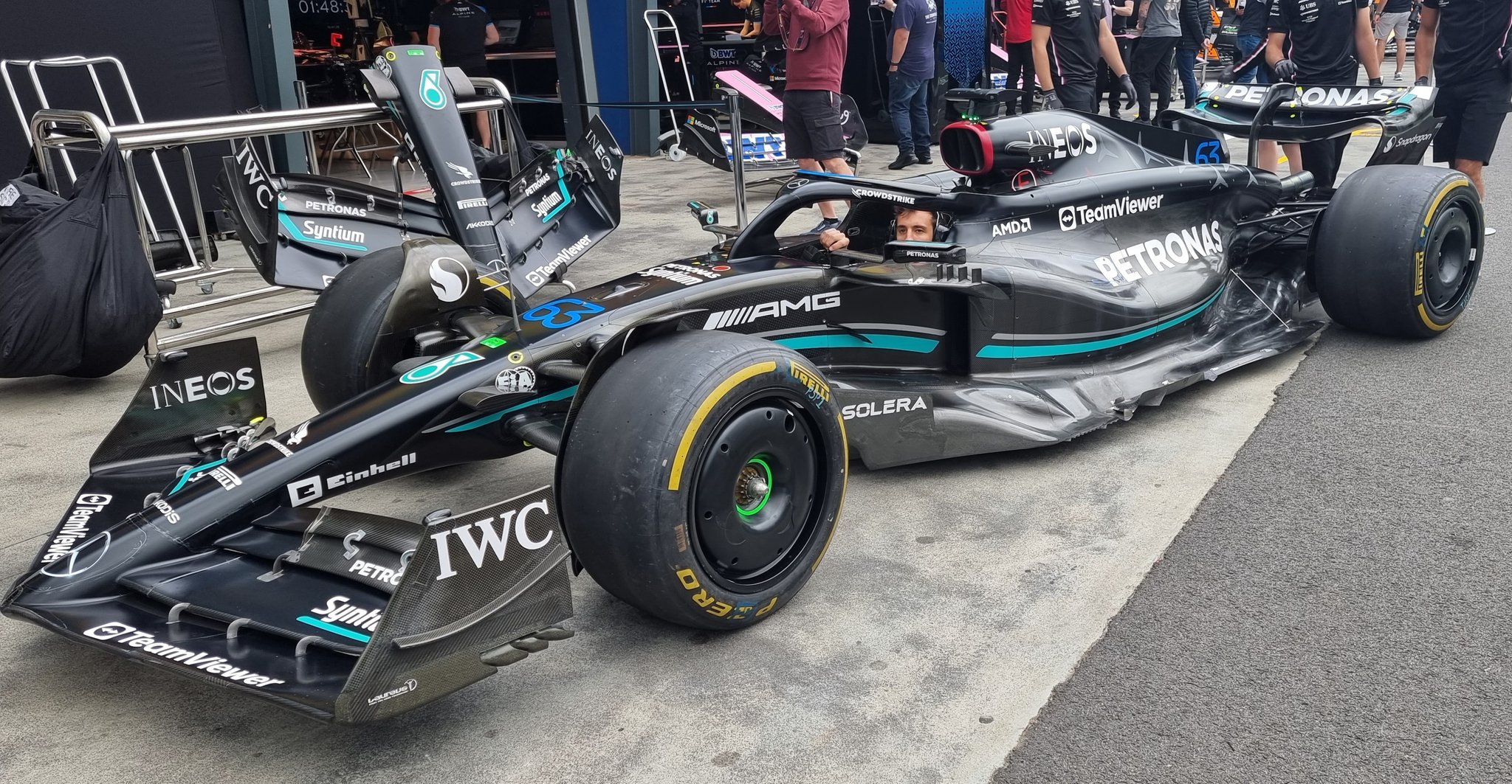

The much discussed cockpit position of the Mercedes has finally been commented on..
Hamilton went into a little more detail about the problems plaguing him: "On the W14 we weren't able to fully resolve the problems at the rear and I personally find it difficult to adapt due to the very forward driving position."

Is the forward driving position something that can be modified to Hamiltons liking with the modified package coming?
Re: Mercedes W14
dfegan358 wrote:
30 Mar 2023, 09:07
I think changing it would require a different chassis

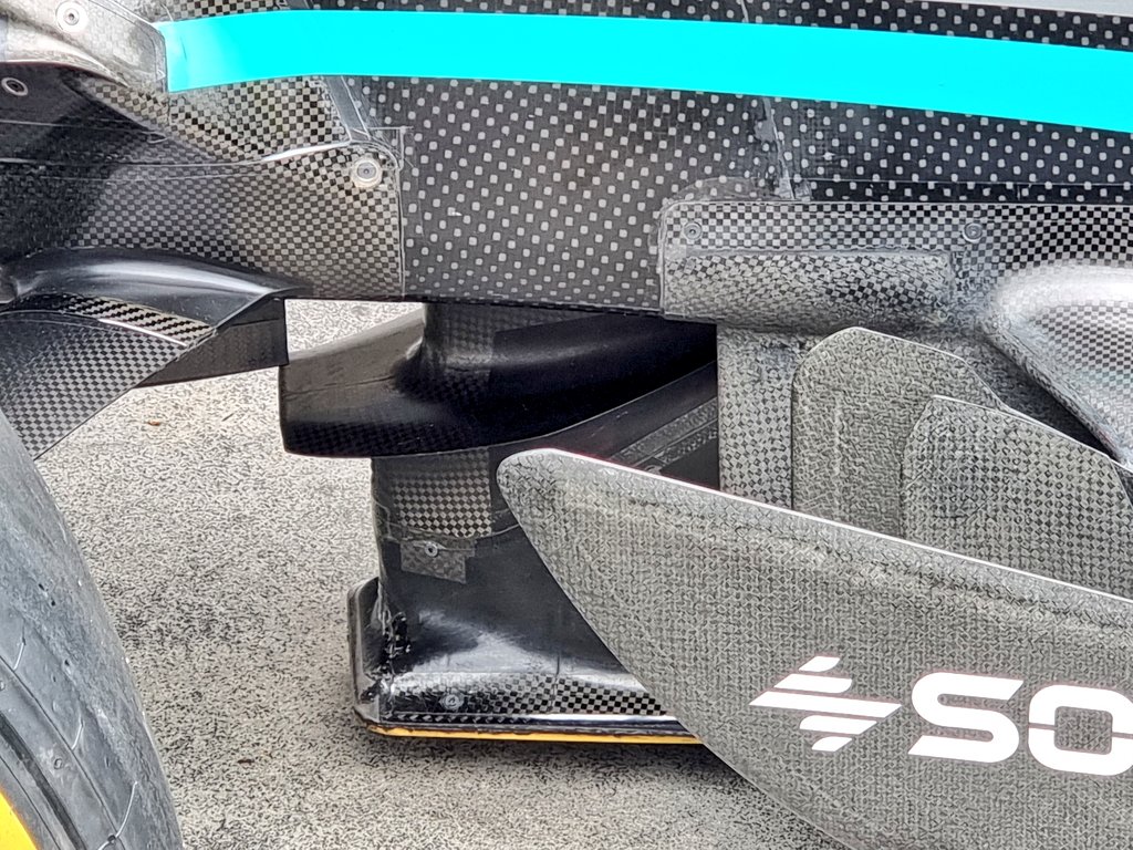

The W13s upper floor beneath the sidepod entrance never made sense to me with all its bumps and curves in the way of th le flor front of the floor to the diffuser.
The W14 does nothing to take away that confusion. I can understand that there's no undercut, but I don't understand the many many bumps on the floor that would impede clean flow from front to rear of the upper floor surface.
Is it all just compromises for stiffness and lower sis location? If so I can't see where it's worth it.

GrizzleBoy wrote:
30 Mar 2023, 10:20
Those shapes are driven by the tunnels and actual underbody floor shape. They are way more important than airflow over the top, as long as you can seal the floor and keep the downforce consistent at different ride heights.
Re: Mercedes W14
30 Mar 2023, 09:04
@Blackout and others vindicated :P
This doesn't really say much other than the radiators are forcing the back of the driver seat to come forward. The halo and pedal box positions are very likely still at the limits.
