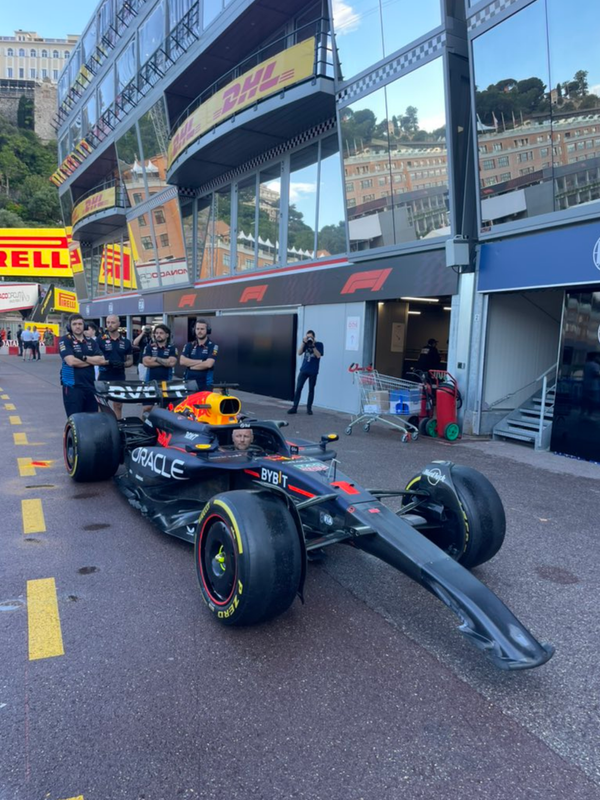

Re: Red Bull RB20
From JameyPricePhoto twitter:
#ReleasetheADUO
https://i.postimg.cc/W30Jx21y/image.png
Isn't that the Monza spec, low downforce spec? 🤣

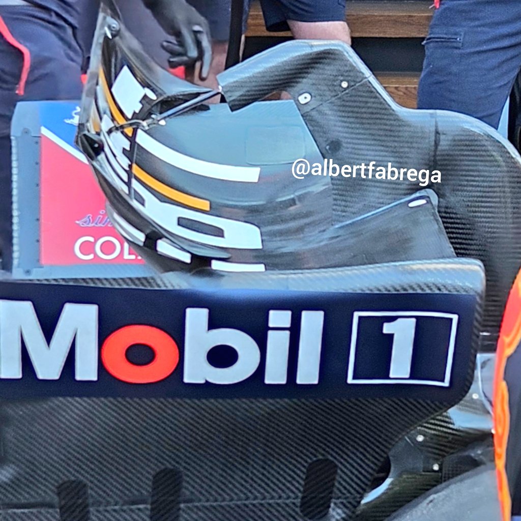

Re: Red Bull RB20
Upgrades for Monaco
1143
Re: Red Bull RB20
fabrega
