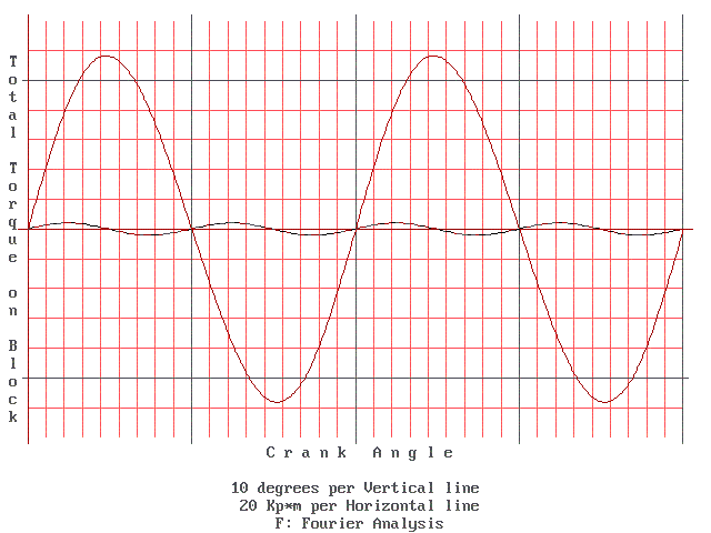

In the program balance.exe at http://www.pattakon.com/pattakonEduc.htm “Total Torque on Block” is the pair of inertia forces (rocking couple) applied on the casing in case the crankshaft is forced to rotate at constant angular velocity (say, by securing on it a huge flywheel).
Here is the comparison between this inertia torque in the typical I-4 with the plane crankshaft and in the same I-4 with a crossplane crankshaft:
The small one (less than 5% of the other) is of fourth order, the other is mainly of second order.
One can imagine it as a wave in the sea.
If the “crossplane crankshaft” wave is 1m high, the “plane crankshaft wave” is more than 20m high (we talk for two four cylinder engines having same pistons, same connecting rods, same stroke and running at same rpm).
If the crankshaft/flywheel/load is allowed to accelerate – decelerate, then the above inertia torque gives an idea of the resulting “crankshaft speed variation”.

Hello Tommy Cookers.
Suppose:
50mm stroke
80mm bore (i.e. per cylinder capacity: 250cc)
100mm center to center con-rod length
500gr mass of the assembly of piston, wrist pin and top 1/3 of the connecting rod.
peak torque: 110mN at 12,000rpm
peak power: 200bhp at 14,000rpm.
At 10,000rpm a conventional four in-line (plane crankshaft) suffers from a free inertia torque of 700mN of 2nd order (it also suffers from a free inertia force of 14,000N (1.4ton), of 2nd order too, but this is another story).
At 10,000rpm, the cross-plane version of the same engine is actually rid of free inertia force and torque.
In a turn the motorcycle / rider is leaning as much as the turn and the speed allow.
Suppose that the rider needs, during the turn or near the end of the turn, only a part of the torque of his engine, say only 40mN.
He puts third in the gearbox, he engages the clutch and he opens slightly the throttle.
The engine is revving at 10,000rpm and is sending 40mN of “useful” torque (from the 110mN peak) to the transmission.
In the cross-plane version of the engine, the rear tire receives only useful torque (the 40mN provided by the engine multiplied by the total transmission ratio).
In the conventional (plane crankshaft) I-4, the rear tire receives the useful torque (the 40mN provided by the engine multiplied by the total transmission ratio), it also receives the useless inertia torque (the 700mN free inertia torque generated by the engine multiplied by the total transmission ratio).
With the typical shape / form of the instant combustion torque provided by the engine, in order to get an average of 40mN torque you need an instant torque varying from, say, -40mN to +100mN, i.e. a total variation of 140mN, while the free inertia torque of the conventional I-4 varies from –700mN to +700mN, giving a total variation of 1400mN (ten times higher).
Think for a second about it: the useful torque (i.e. the combustion torque) passes like noise inside a huge inertia torque that does nothing useful, only friction and stressing of the parts.
A bad thing for the plane crankshaft is that the basic frequency of the combustion torque is the same with the frequency of the free inertia torque. A high frequency torque absorber in the transmission cannot “kill” selectively one of them (even if there were such a shock absorber, by killing the free inertia torque you actually kill a part of the power; think of it).
So, while in the one case (cross-plane) the engine feeds the transmission exclusively with combustion torque (i.e. useful torque), in the other case the engine feeds the transmission system with the same useful (combustion) torque plus a ten times higher and useless inertia torque.
Even if the full throttle is open at 10,000rpm, the useful torque is still four times smaller than the inertia torque.
If you increase the revs to 14,000 of the peak power, things get two times worse because the inertia torque doubles ( (14,000rpm/10,000rpm)^2=2) while the useful combustion torque falls slightly.
So, there is a significant difference between the two arrangements.
The drawbacks of the cross-plane I-4 is the uneven firing and the need for an external counter-rotating balance shaft.
The Cross-Radial PatAT / PatATeco is rid of the drawbacks of the cross-plane I-4 because it does not need an external balance shaft and because it is even firing.
As for its crankshaft, it has only one crankpin and only two basic journals which, by the way, are rid of inertia loads.
The crankshaft is both: lighter and stronger.
Thanks
Manolis Pattakos

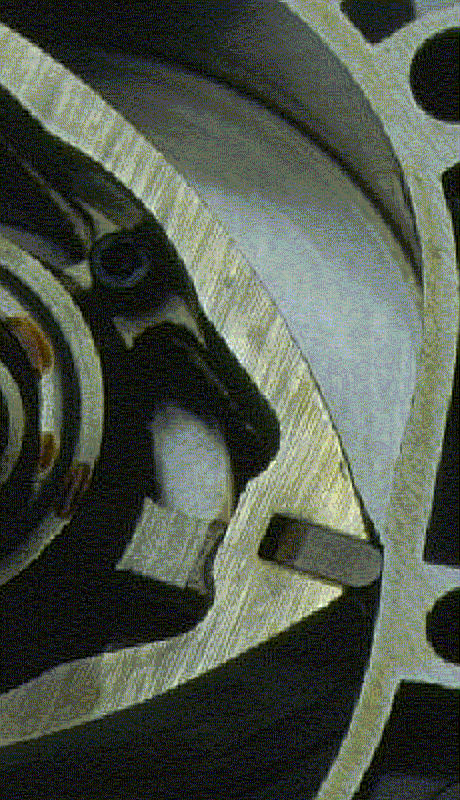

In practice there are some engine arrangements proving the previous “theory.
For instance the following OS Wankel model engine (no side seals):
Read at
http://www.f1technical.net/forum/viewto ... &start=795
and
http://www.f1technical.net/forum/viewto ... start=1020
the comparison of the leakage in the PatRoVa and in the OS Wankel model engine.
