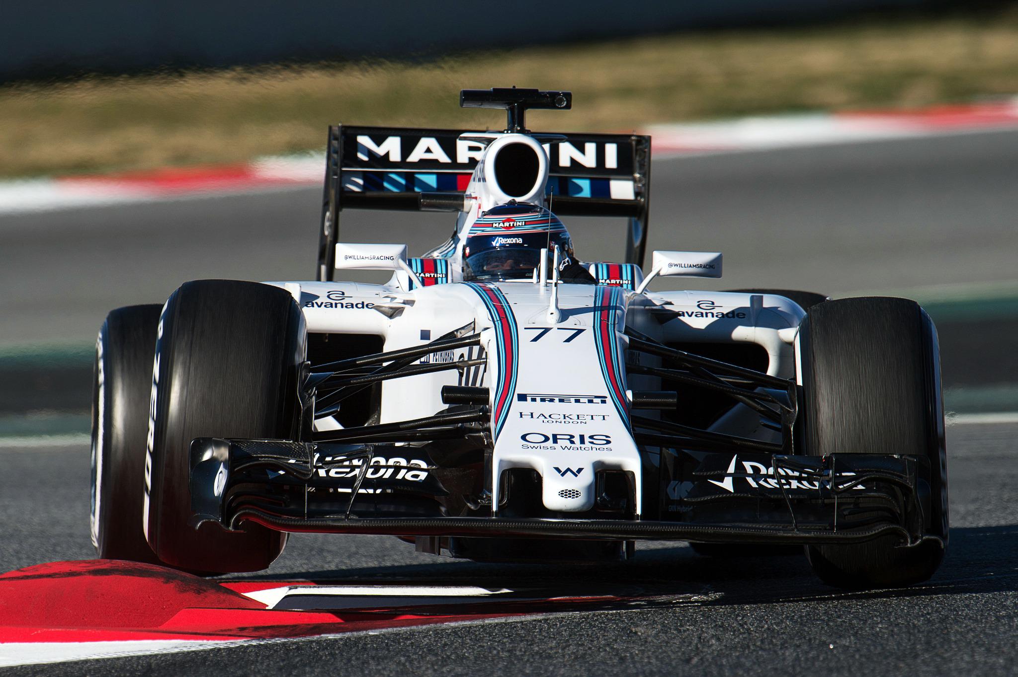

Shape of the sidepods is quite nice, no abrupt cuts.

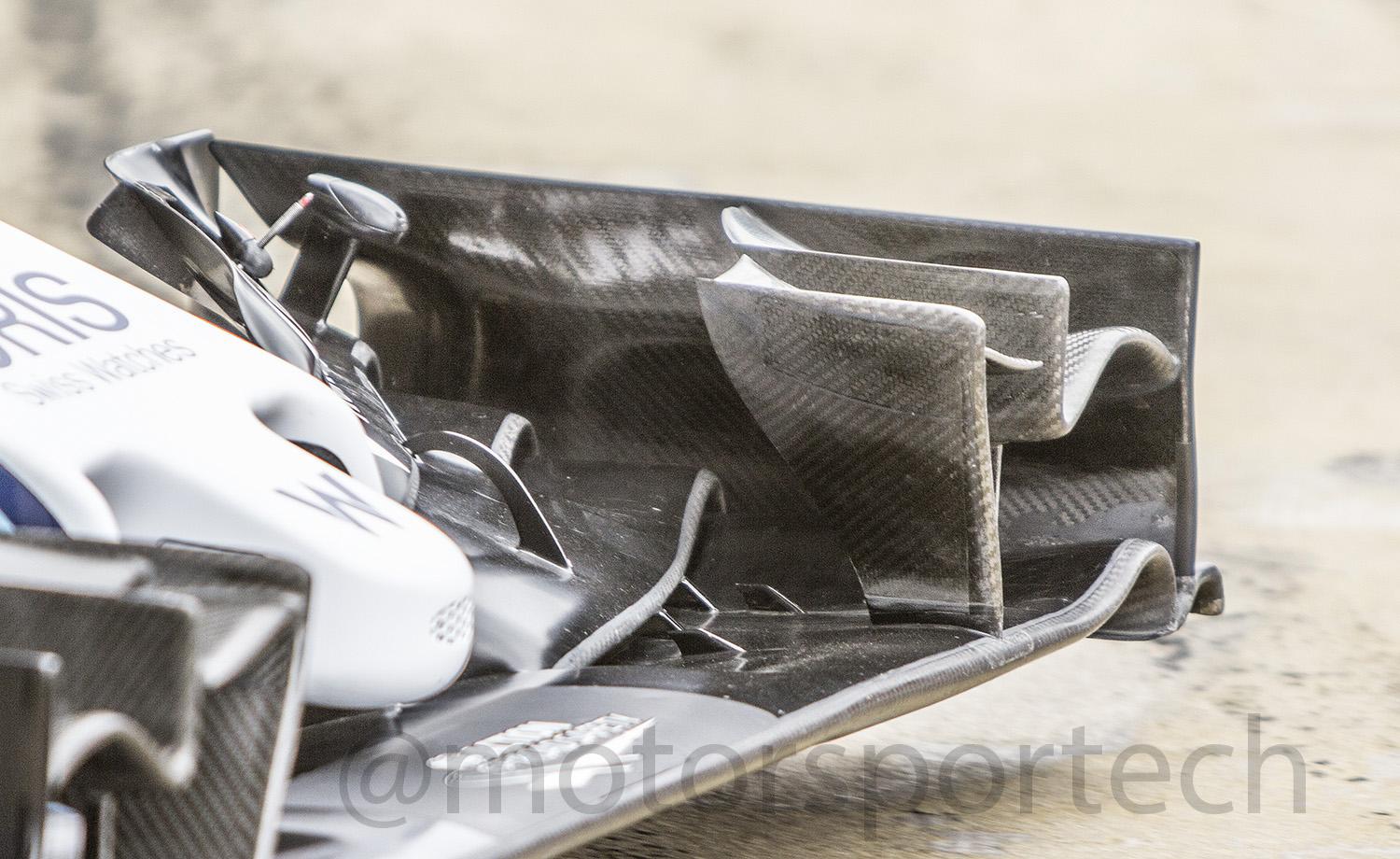

Some details have changed on the front wing:
Yellow represents the cut away in the upper element before the upper element strake/flap adjuster, in front of the wheel. Note that area can't be adjusted by changing the flap angle, so it's definitely a structural change.
Red represents the new upper element strake, which is more elaborate and a bit thicker.

And some detail on the Williams front wing
Re: Williams FW37 Mercedes
Oh I didn't know the strake also sticked out of the back of the upper element (note: older wing). That's interesting since that'll create vortex at that spot. Perhaps one to seal the inside wall of the tyre.

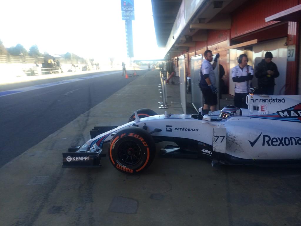

WILLIAMS RACING ‏@WilliamsRacing 3m3 minutes ago
Valtteri is wheeled back into the garage after his latest run. It's windy out on track which will mix things up a bit
