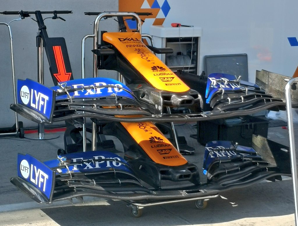

Is it me or the wing in the top has a different Y250 approach (the one below seems to be the Spain update)

A friend told me that that’s the reason why the MCL34 doesn’t use an S-Duct, they found that they additional aerodynamic benefit wasn’t enough to compensate for the increase in drag... I always find it interesting that Mclaren seemed to be the only team not using one.
We may well see an S-Duct shortly now the Renault is up to full power and the tyres seem to need more DF to give setup options.
SmallSoldier
SmallSoldier
488
Joined: 10 Mar 2019, 03:54
Re: McLaren MCL34
PhillipM wrote:
SmallSoldier wrote:
25 Jun 2019, 19:50
That will be an interesting development, hopefully the added weight (I’m sure the structural integrity of the nose will need to be addressed) compensates for it.
If I’m not mistaken, the use of the S-Duct is mainly to take care of the dirty air flowing towards the underside of the nose and therefore having a negative effect on the turning vanes and front part of the bargeboard area?
386
Joined: 16 May 2011, 15:18
Re: McLaren MCL34
Yes, just cleans up the boundary layer under the nose and dumps it in the low pressure area above.
