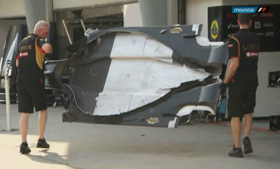

Differences exhaust manifolds: Lotus - Ferrari
