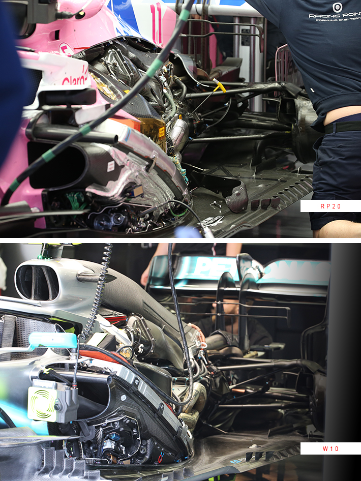

People are discussing all about the exterior and aerodynamics. But there is one thing that is way more important in this scenario; packaging. Mercedes has put in significant amounts of work to get a rear end that is as tight as possible. Theirs is really extreme in that regard.
Last years Racing Point didn't even come close in that regard, yet for this year it is just as shrunk as the Mercedes is. You can copy the outside of a car, but not really the internals. And yet, Racing Point has somehow managed packaging all other midfield teams can dream of.
good point but they can have the packaging quite legally, as it's not 'bodywork'. Radiators, coolant, pipes, drawings, little clips, wiring, connectors, ducts, screws, whatever :) And they have plenty of engineers to work on it as well
Look at last year's Racing Point again. It was quite tightly packaged! But anyway the 2020 RP engine cover is not a total Merc imitation as you can see.

Is RP also using a hidden water-air intercooler like Merc? I do not see any duct between the left sidepod heat exchanger (were FI used to put their air-air intercooler since 2014) and the intake plenum... Both of the intake plenum air ducts seem to go downside in 2020 while both ducts used to come from the left sidepod before
2014-2019:
Now:

Still looks like an air intercooler to me, just packaged differently.
