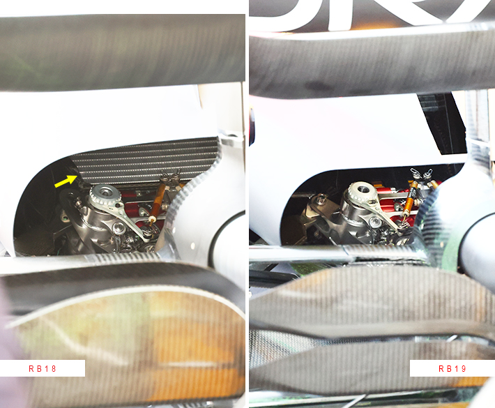

https://pbs.twimg.com/media/Fpu1veMXwAA ... me=900x900
Nicolas Carpentiers 📸
Might've been moved to take advantage of the slot below the sharkfin
https://pbs.twimg.com/media/Fpu3LyaXsAo ... me=900x900
That is a surprising view! I really thought they increased the cannon exit, but its actually much smaller. Great post!
Looking at the suspension it seems like somebody has been carrying over a LOT of parts.
I'd question; did they move it or is it just smaller to save weight and will they fit the bigger one on circuits with a high cooling demand?

It's not surprising that the actual cannon has got smaller. They've opened the slit beneath the sharkfin which they trialled at Singapore & Mexico last year.
In addition they're taking advantage of the outlet where the suspension inserts to a greater extent on the rb19:

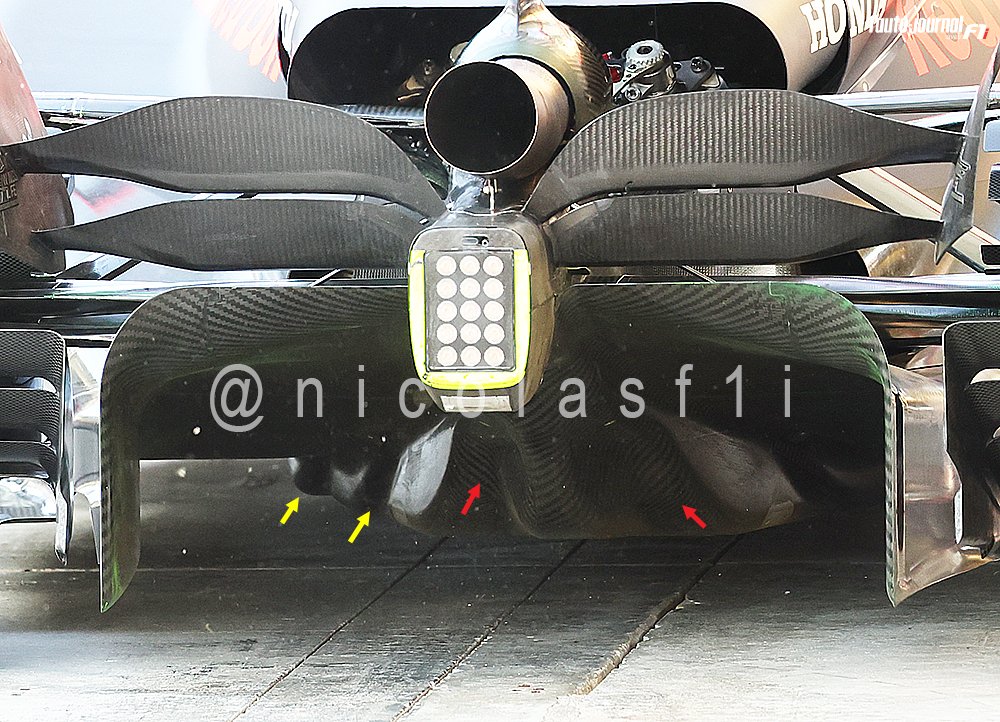

Ok I thought Fabrega got a good photo of the diffuser. Nicolas goes a step further. Seeing the carbon fibre layup allows the curves to be more obvious:
https://pbs.twimg.com/media/Fpu4XNTWYAc ... ame=medium
Are those indents being used to roll up vortices that flow up centrally through the diffuser? I wonder if collectively, they help keep flow attached + work in tandem to create two counter-rotating larger flows next to each other?

I'm not sure, but allways regarded them as exactly the same devices in intent as the device on the floor edge. They are there to extract air from the floor area to keep the pressure low
