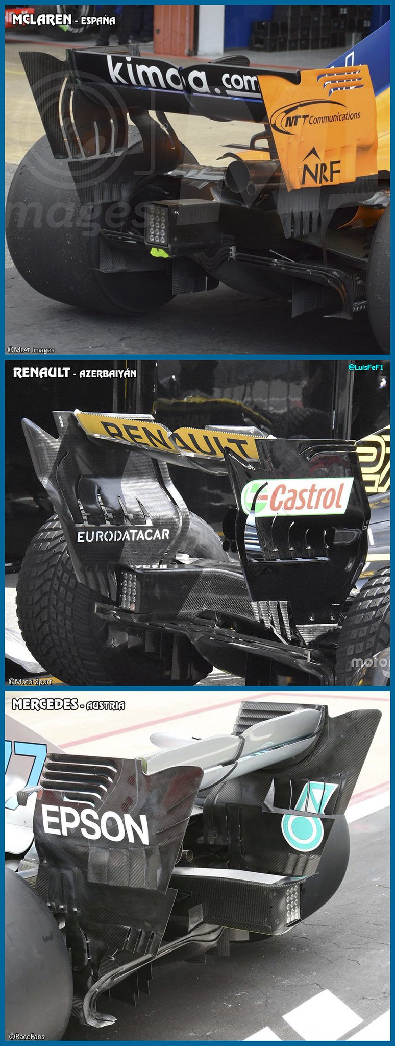

Re: McLaren MCL33
Rear wing inspiration across the paddock
