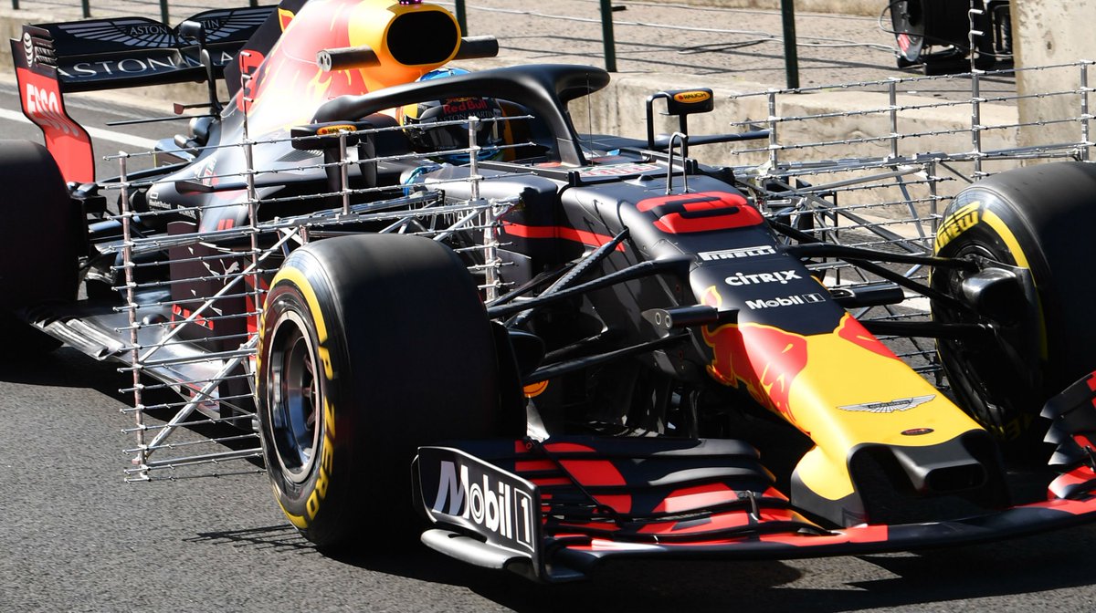

Seems like Red Bull only took off the cascade elements.

Re: 2017-2020 Aerodynamic Technical Regulations
Looks like they are still trying to make out-wash front wings! #-o
Although they do appear to have severely limited options now.

jjn9128
785
Joined: 02 May 2017, 23:53
djos wrote:
31 Jul 2018, 13:17
I'm getting annoyed with this in-wash stuff. FIA/FOM never said they'd be looking to in-wash the front wing tip wake - just reduce the aggressive out-wash which increases the car's wake width to the detriment of other teams, then Scarbs and the motorsport network got it wrong and started all this nonsense. That said, a wide span wing does not necessarily mean the tip vortex passes around the outside of the wheels - read the work of Diasinos on front wing span and wheel vortex interactions.

The endplate seems much taller, teams aren't even using the full span at this point.

Yeah, the wings are deeper, that's why.
As jj says, they're not going to go for in-wash wing designs. Especially not with even wider wings. They're going to go for more up-wash to lift air over the wheel rather than around the outside, that's all.
If the FIA wanted in-wash wings they would have narrowed them another 20cm.
