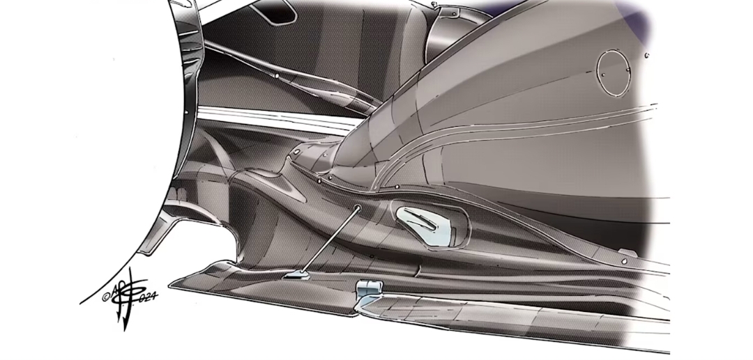

Looks like the new diffuser wasn't ready for COTA but has made it to Mexico??

Looks like the new diffuser wasn't ready for COTA but has made it to Mexico. Significantly revised
@danielealofan on twitter for pics, not sure of photographer unfortunately
Baku
https://i.imgur.com/S0KTCjl.jpeg
Cota (by Nicolas Carpentiers)
https://i.imgur.com/cox7aWD.jpeg
Mexico
https://i.imgur.com/VLx2bTu.jpeg
Hard to see the changes. If this is a new diffuser I guess Max will get it and Checo will drive the Austin floor.
Baku
Mexico
It's exactly the same mate
Look at the angle between the keel thingy that was added in the middle (the bit that is bonded on) and the top of the roof. Baku vs Mexico. Now it's a straight line, before there was an angle.
One is taken from below and one from above, ofc the angle looks different here. But it's the same
Since Baku they've brought an entirely new floor and the info from inside the team is that the diffuser has been the main focus of the latest development (to reduce instability). It's not a question of if there's been a change it's a matter of when. The angles aren't the same here, but there is a large difference in keel geometry between the new spec and the makeshift Baku spec. Unfortunately there aren't many pics from cota so we can't confirm if the update was there, but I'm told that it was on the car for cota.
