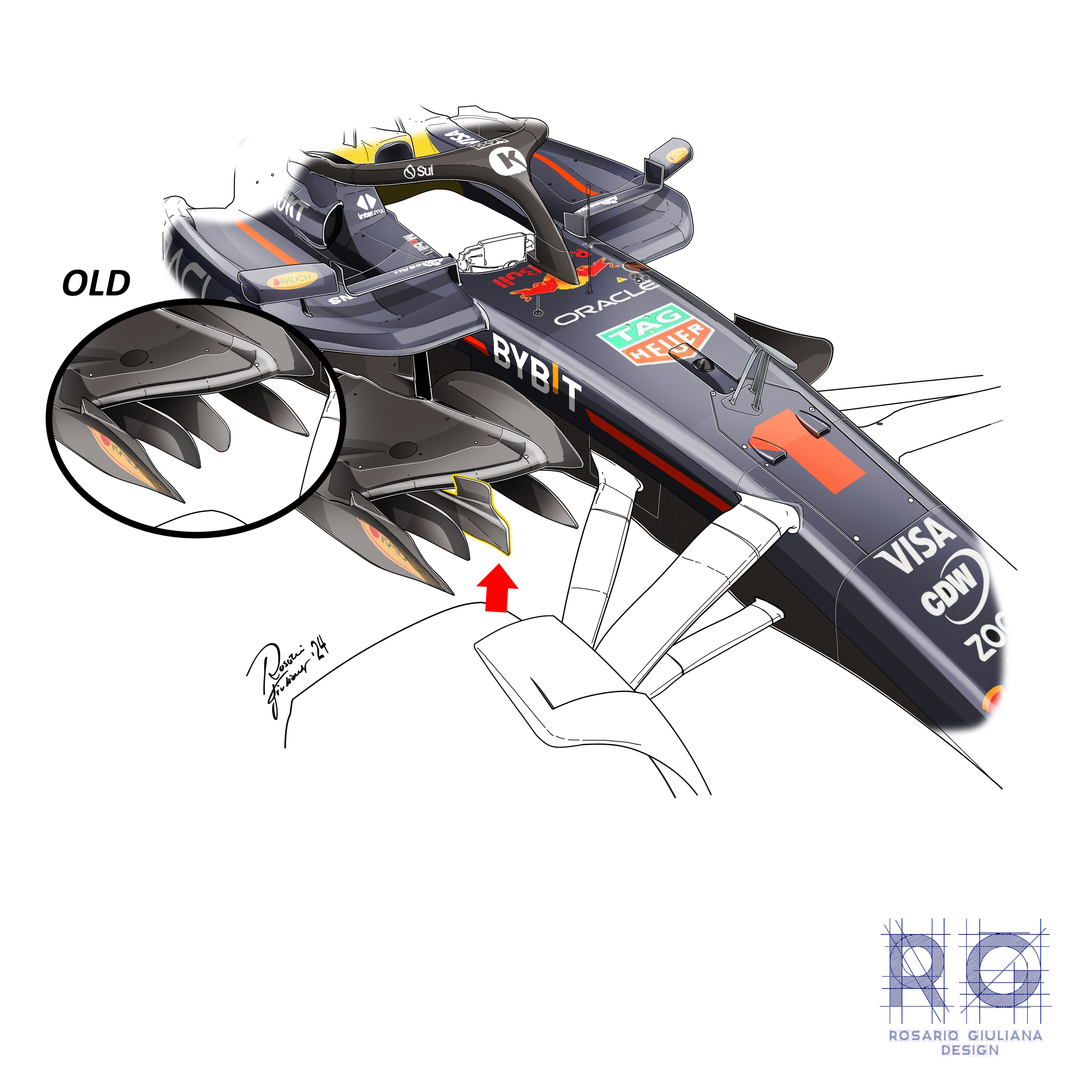

Red Bull showed their R22 update at the Las Vegas GP. The update included a revised forward floor fence geometry changing the height and placement of the fence forward surface. From what I’ve been told, the aim of this update is to have better forward floor extraction resulting in more outwash to the forward floor edge. This improved extraction and outwash MAY result in,
🔵 Improved forward balance with better forward floor load. More on the nose feel.
🔵 better front Tyre wake control with improved edge outwash
🔵 Less ride height sensitivity for better overall setup balance
