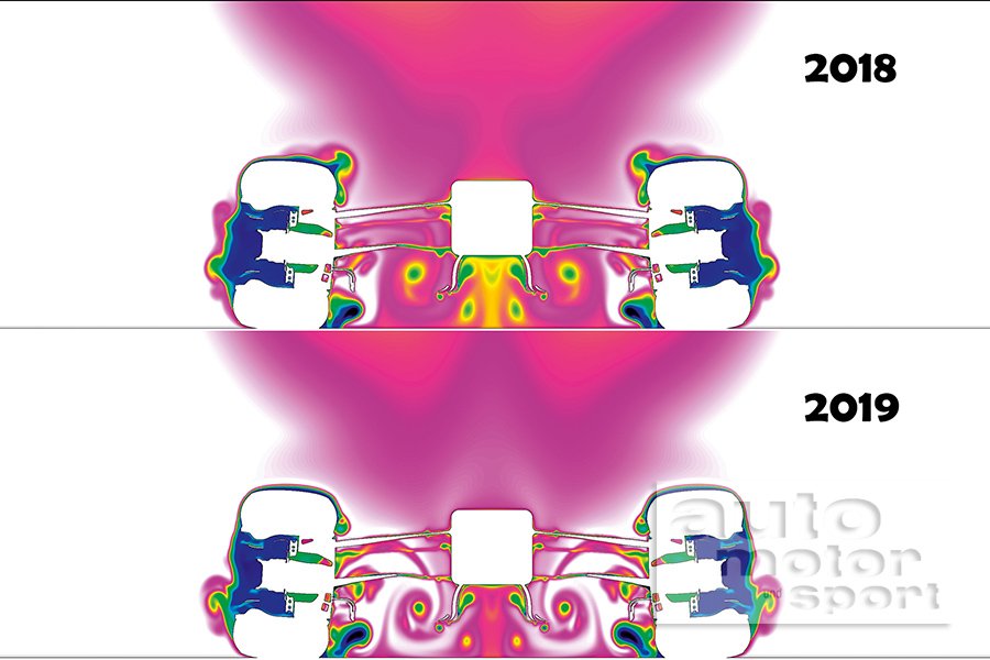

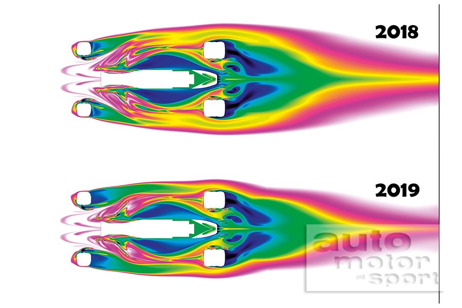

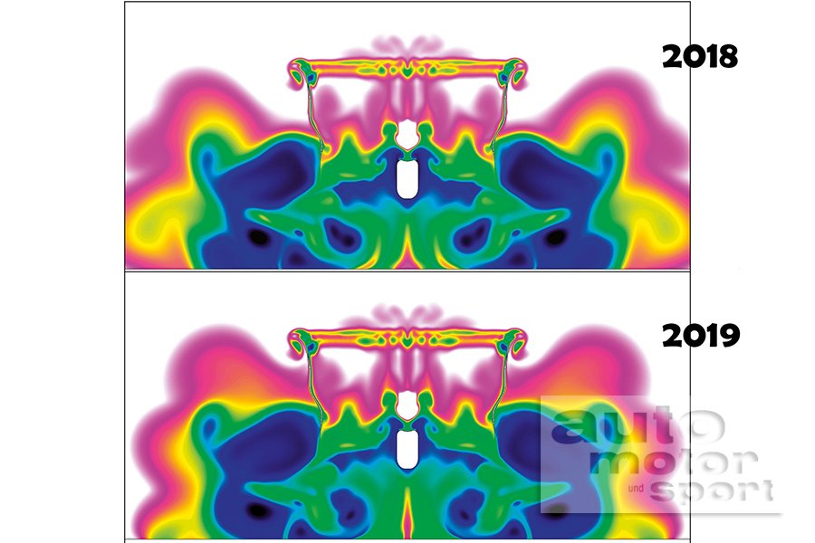

CFD images of comparison between 2018 and 2019 aero change.
Visible effect of reduced outwash. Tyre wake staying closer to the car and hence diffuser.
View from rear end. Notice reduced outwash on the sides of the rear wheels.
Air effecting following car.

jjn9128
786
Joined: 02 May 2017, 23:53
Re: 2017-2020 Aerodynamic Technical Regulations
M840TR wrote:
17 Aug 2018, 11:06
Interesting. Not sure it's an entirely legal 2019 car as I can see vanes on the front brake ducts, but it does highlight that there will be a difference. The top render is not the car which was used in the CFD.
Not sure you can see outwash on a total pressure contour but the wake is certainly narrower. Numbers would be more interesting to see IMHO as they affect wake values - so what is their Cz/Cx - what is the effect of 2019 rules on Cz/Cx - what is the effect of another car on Cz/Cx - what is their axial separation? ...etc

Can you explain the mechanisms at work in the vertical images above?
jjn9128
786
M840TR wrote:
17 Aug 2018, 12:43
I think these are from the initial study done by FOM so might be a bit rough on the edges. Numbers would give more insight but I'm not sure they'll be published.
Hmmmmm I wouldn't have though FOM would release those... but that front brake duct vane and the wheel cone design do look like the 2017 Manor - which FOM are using for their research.
The rear impact structure shape looks similar too.
M840TR wrote:
17 Aug 2018, 12:43
At the very back of the car you have something a bit like this, which you can sort of see in the images.
The dominant vortex structures are the rear wing tip pair, which pulls all the other wake structures into a "mushroom" shape. Less outwash around the front wheels means the wake is narrower around the car so the mushroom stem (the bit which really affects a following car) is made narrower. You can see the effect of that on the slice through the front axle where the cleaner air (white) is more visible around the wheels. Meaning the car will be losing less downforce. You can also see some of the front wing cascade vortices in the 2018 image which are no longer there in the 2019 image.
