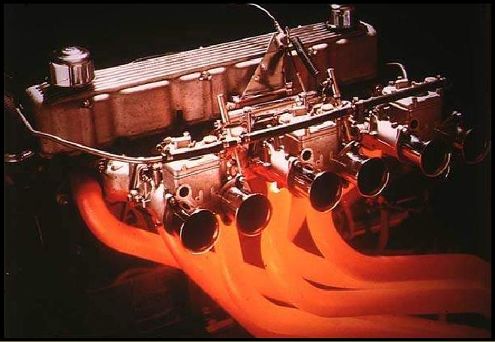

Re: Puckering a velocity stack to lower cfm.
Back in the day, GM put Quadrajet 4-barrel carbs on heaps of different-sized
engines from mid '60s inline 6 OHC Pontiacs, to huge displacement Cadillac V8s.
AFAIR, the last of the Holden 253's got 'em too, & with that small primary
plus large air-demand secondary, the Q-jet system worked well, good enough
for Grice to win at Bathurst in the 1986 homologation Group A Commodore VK.
Hemi 265's could shift a fair bit of air, with true 12 port/big canted-valve heads.
Weber carbs had replaceable venturi-throat 'chokes' to adapt to CFM requirements,
of different internal diameters within the size-range of the basic carb body type.
