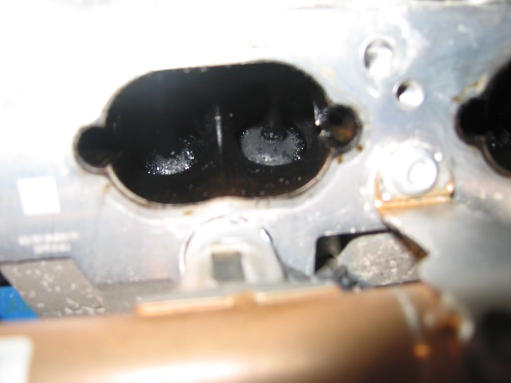

F1_eng wrote:It would also bring with it a host of other problems in regards to combustion.
Do you know what these could be?
Oh yes! Image
This hasn't happened to mine yet, but I have a heavy right foot, and this does apparently help!
F1 engines are rebuilt every few races so this build up should not be a problem.
Under part load a direct injection system will save fuel as the mixture will be stratified (lean towards the bottom of the combustion chamber) and ideally not ‘touch’ the cylinder walls after ignition - reducing heat. At full load, the fuel is injected synchronously with the air intake phase and this fills the combustion chamber homogeneously. This has the advantages of reducing the tendency to knock and improves the internal cooling.
