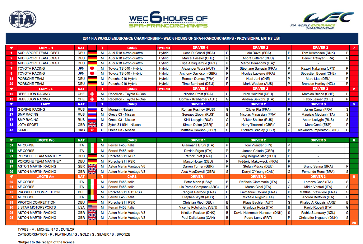

Here is the entry list for the next race - 6 Hours of Spa

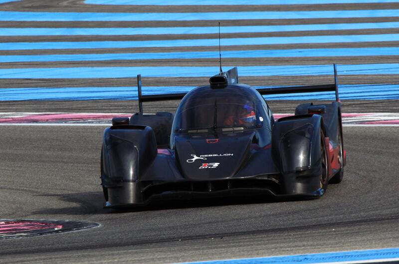

And another shot of the new Rebellion R-One
