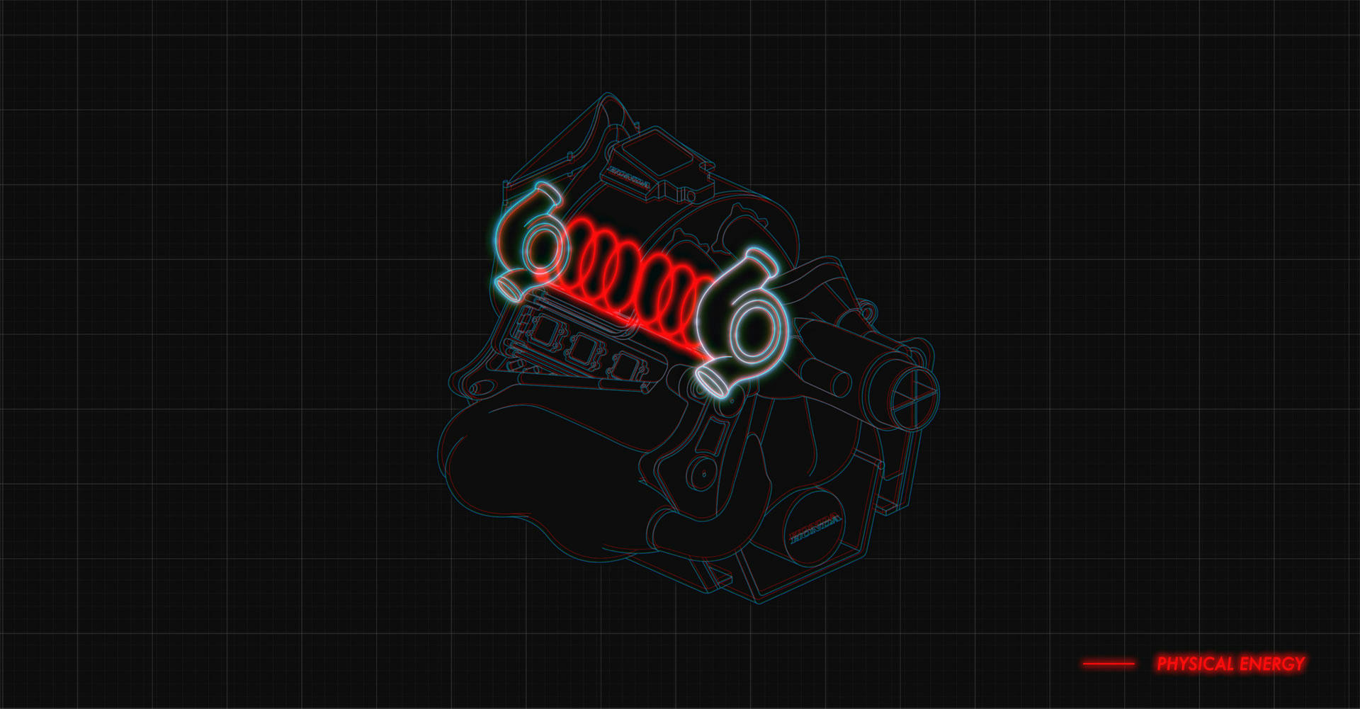

ispano6 wrote:
20 Jul 2019, 16:48
Is this new information? Honda has shown this since the beginning of the season.
Dual inlet, dual outlet, split turbo physically connected and it's orientation.
http://www.mediafire.com/convkey/f8e4/1 ... h409zg.jpg
At one glance you can instantly tell that that thing does not work. Graphical materials for this sort of things are just casual diagram, same as tube maps, anatomical explanation drawing of organs etc, not something to take serious about.

muramasa wrote:
20 Jul 2019, 19:20
ispano6 wrote:
20 Jul 2019, 16:48
Telling orientation of turbine rotation is so easy, just look at its body will do.
Obviously, they are not showing exact details. All I'm saying is this information is not new. Dual outlet and dual inlet that is.
