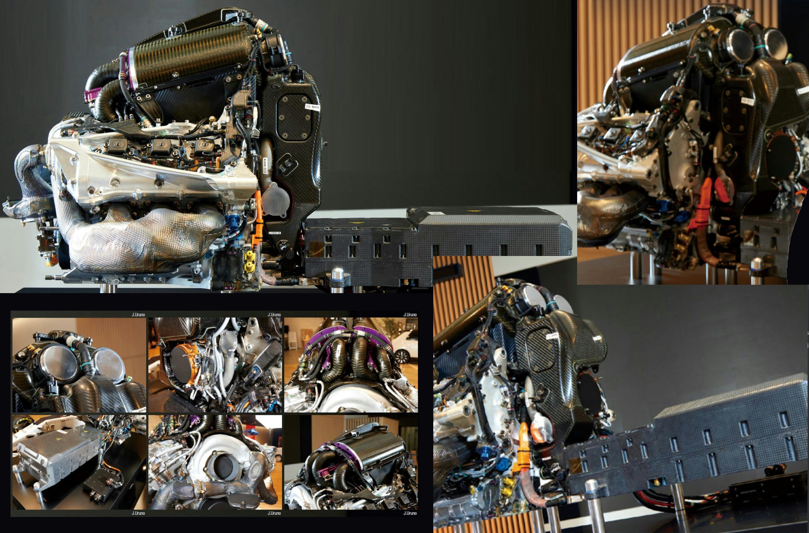

I think people are mistaken. It still looks like a twin entry to me but with a tube between the two exhausts. Why they did this I'm not sure. Maybe some kind of pulse tuning?
You can see the same setup if you zoom into the middle picture on the bottom row of the 6 pictures. There are clearly still two turbine entries with a tube joining the left and right exhaust banks.
https://www.mediafire.com/convkey/83e9/ ... ?size_id=f
I agree about the two turbine entries. I think the tube between the exhausts connects up to the wastegate. They used to position the wastegate above the turbine, neatly sloped to minimise the need for bodywork around it. The exit to the cross tube(s) is below the exhaust which matches the wastegate outlet location they have been using more recently.
The pipes connecting to the wastegate leave the exhaust at right angles suggesting they are for pressure relief leaving the path to the turbine for pulses (kinetic) clear. Last time I saw the Renault setup it was the same, albeit with the wastegate itself above the turbine.
I think Mercedes also have a cross pipe below the turbine, but in the pictures I’ve seen it has a heat shield over it so I don’t know if it’s connected with wastegate use, or as you suggest for Honda, it is used for some tuning.

The waste-gate/s in/out exhaust gases are those that have 'bypassed' the exhaust turbine housing. in short, the waste-gate/s does not receive exhaust gases from the exhaust turbine housing. When the waste-gate/s are opened the exhaust turbine is totally free of any pressure. (free load mode).
