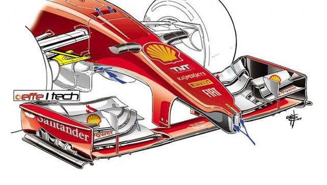

Do you think this Red Bull / Ferrari F-duct nose will come to fruition?
For a moment it felt very "Gary Anderson" like (image quality etc)

Re: Ferrari SF15-T Pre-Launch Speculation Thread
It could, as imho it's more of a 'mashup' between the Marussia 2015 nose and the 2014 RedBull nose.

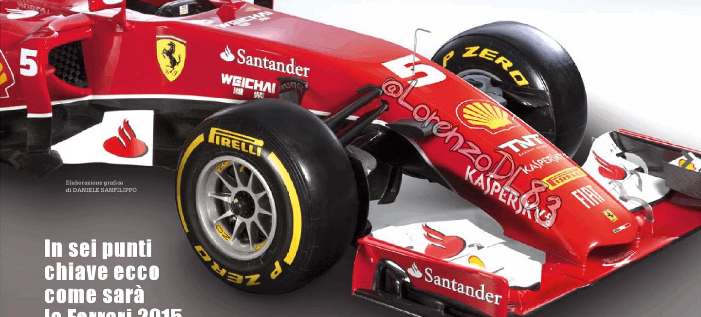

Autosprint speculates this kind of nose
SF15T with intercooler in the V of the ICE, 500 bar injectors, very short Mercedes style manifolds. oil tank no more in the gearbox spacer but between engine and chassis. Nose low and flat , pull rod suspension.
the missed renovation of the front suspension (from pull to push) would have resulted in a major changes of the chassis diverting forces and men from the most critical areas where instead it was possible to intervene

Looks good
But intercooler within the V would mean a turbo layout similar to last year

Can someone help me here? Will they really be able to get anything like the same amount of cooling with their intercooler on top of the engine where it's very hot, compared with a team that has the intercooler in the sidepod. Clearly, there'll be packaging advantages but it seems like a strange one to me. Thoughts from someone with more technical insight would be appreciated!

Ferrari use a liquid to air intercooler.
That means that there are two parts to teh intercooler. The part in the vee cools thair with coolant. The coolant is then routed to a radiator mounted in the sidepod. The radiator should be smaller than an air to air intercooler.
The other advantage is that the path from the compressor to the inlet is shorter than required by routing it through a sidepod intercooler.

Thanks Wuzak. I can see there are advantages to this system but I imagine there is also extra weight with regard to the coolant and the pump used to move the coolant. Interesting.
