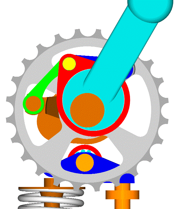

Explaining the patVVD:
The cyan part is the cam shaft whereon a cam lobe is pivotally mounted; the cyam cam shaft rotates at constant angular velocity.
The patVVD mechanism (not shown here***) causes a fluctuation of the angular velocity of the cam lobe along a camshaft rotation.
https://www.pattakon.com/VVD/PatVVD_explained.gif
(slow motion at https://www.pattakon.com/VVD/PatVVD_explained_slow.gif )
The animation has a slide per 6 degrees of camshaft rotation (or per 12 degrees of crankshaft rotation).
At a first position of the control pin (not shown) the camlobe (shown red in this case) rotates slowly when its nose passes over the "for more: www.pattakon.com" label (at bottom), and quickly when its nose passes over the "patVVD : pattakon CVVD" label (at top).
At a second position of the control pin, the camlobe (shown blue in this case) rotates quickly when its nose passes over the "for more: www.pattakon.com" label (at bottom), and slowly when its nose passes over the "patVVD : pattakon CVVD" label (at top).
If the valve actuator were where the bottom label is, the valve duration with the control pin at its first position (cam lobe red) would be more than 70 camshaft degrees longer than with the control pin at its second position (cam lobe blue).”
***the mechanism is explained by a windows “exe” animation at thebottompf the https://www.pattakon.com/pattakonVVD.htm web page.

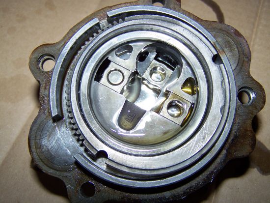

Here is the Rover VVC:

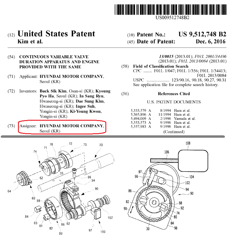

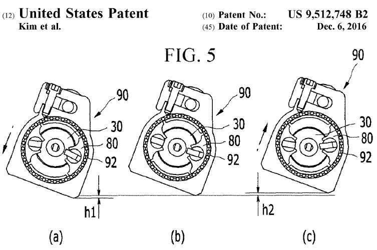

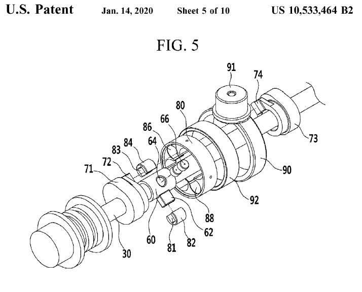

Here is a drawing from the last US patent granted to Hyundai (as the assignee) :
Spot on the 62 and 82 parts.
And here they are shown their differences:
The red part is the 62, the yellow part is the 82.
The pin of Rover VVC has been moved outside, the slot of the Rover VVC has been moved inside.
What a breakthrough!... What a disruptive technology, indeed…

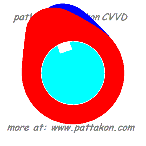

The following animation, added to the patVVD web page at https://www.pattakon.com/pattakonVVD.htm , may be useful in understanding the patVVD mechanism
The control lever (cyan) is displaced at six different angles about the camshaft rotation axis.
Each angle of the control lever defines a different "valve lift profile" the valves have to follow during the rotation of the sprocket:
At https://www.pattakon.com/VVD/PatVVD_Con ... r_slow.gif is the above animation at slow motion.

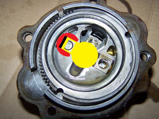

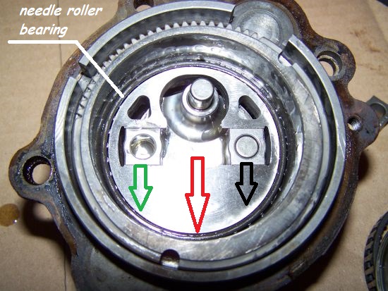

Here is a photo of the Rover VVC mechanism:
The black arrow at right is the force applied by the right pin/rectangle (i.e. the drive shaft) to the intermediate “disk”.
The green arrow at left is the reaction force from the respective cam (i.e. the driven shaft) to the intermediate “disk”.
The red arrow is the total force loading the bearing through which the intermediate “disk” is rotatably mounted on the eccentric control ring (that with the teeths at a portion of its periphery).
The total force (red) is about twice as strong as the driving force (black) and acts on a big diameter bearing; these make a “needle roller bearing” obligatory.

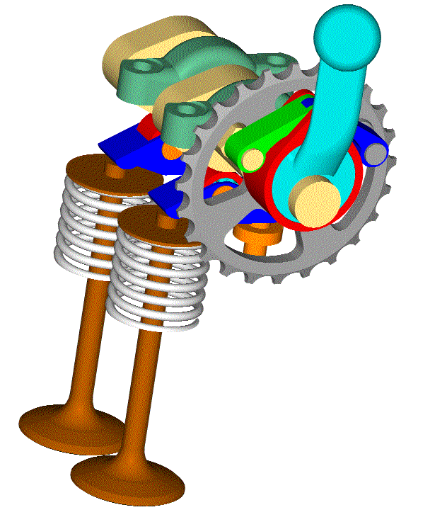

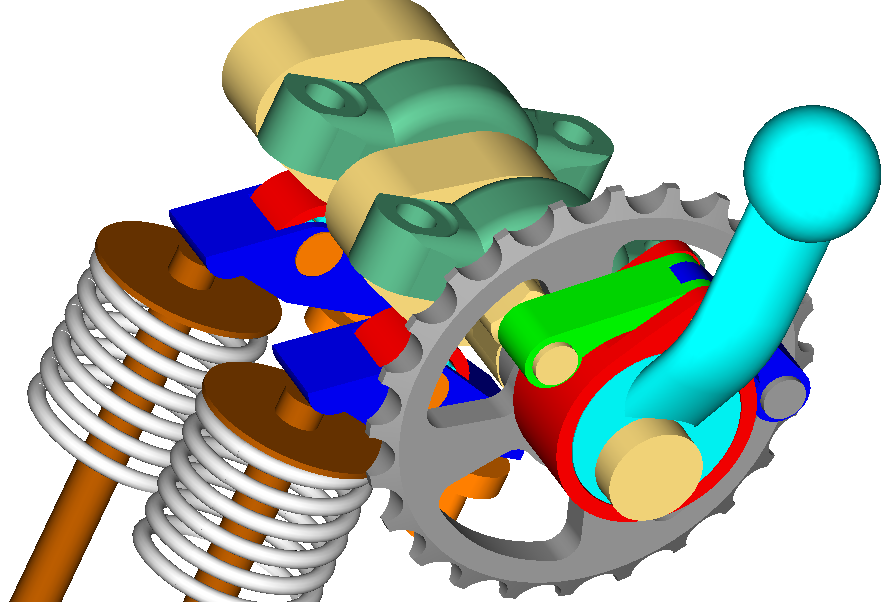

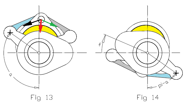

Here is a drawing of the PatVVD:
The red arrow represents the total force; the total force is substantially smaller than the “driving” force (black).
The diameter of the bearing (external diameter of the yellow “control” pin) whereon the total force acts is substantially smaller (say, two times the cam shaft diameter).
After 180 degrees of rotation of the “cam shaft” (Fig 14), the wider angle between the cyan and the gray links / rods reduces substantially the total force on the bearing.
According the previous the use of a needle roller bearing is not necessary / mandatory / useful.
The mechanism of the PatVVD is more compact, more robust, more efficient (reduced friction loss and wear) and simpler / cheaper than Hyundai’s CVVD and Rover’s VVC .
One more thing: the “eccentricity” of the control pin of the PatVVD can be substantially larger than the “eccentricity” in the Rover VVC and in the Hyundai CVVD (the h1 and h2 in the Fig. 5 ofHyundai).
This allows a smaller rotation of the control pin (or control lever).

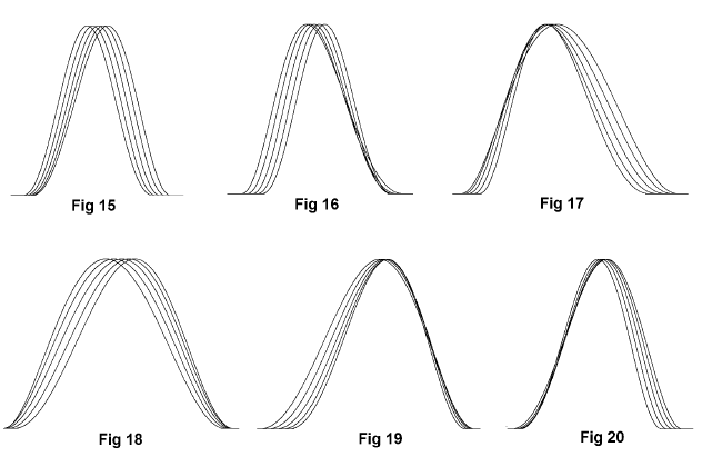

For instance, each of the following sets of valve lift profiles corresponds to 60 degrees of control lever rotation:
For applications without a VVT (like, say, high revving motorcycle engines, like cheap engines etc), the right choice of the region of the rotation angle of the control pin (or control lever) compensates the lack of a VVT (variableValve Timing).

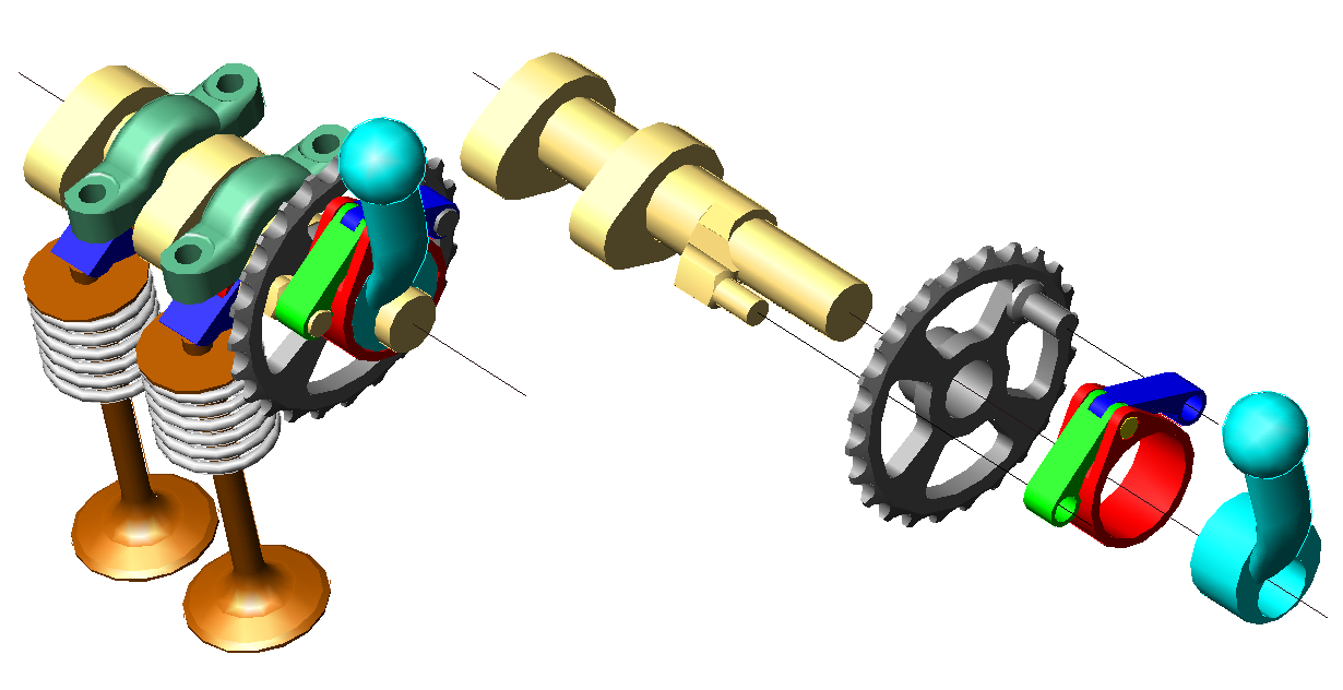

For the support of the mechanism on a cylinder head the PatVVD does not require bearings other than a set of coaxial bearings as those supporting a conventional camshaft on a cylinder head; it also does not require additional structure(s) to bear and displace the control parts.

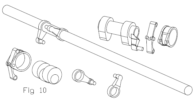

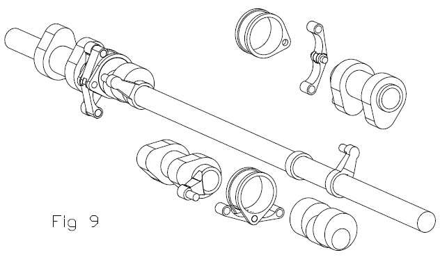

Here they are shown the parts (and their assembly) of the PatVVD for a straight four-cylinder engine:
After the assembly of the camshaft, the complete set is mounted on the cylinder head as a conventional camshaft.
Compare to the assembly of Hyundai’s CVVD: the substantially simpler patVVD is also substantially easier to assemble.

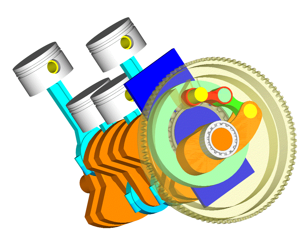

The “same” mechanism is used in the patVRA apparatus:
for the reduction of vibrations transmitted from the engine to the gearbox / vehicle (more at https://www.pattakon.com/pattakonVRA.htm ).
In the PatVRA case, all the power of the engine passes through the mechanism (links and pins) to the gearbox, loading the mechanism not with a few dozens of kilograms, but with a few thousands of kilograms.
While the pins and links (connecting rods) of the patVVD can substantially increase in size, this doesn’t seem necessary.
The mechanism as shown is stronger than what high rpm operation requires.
