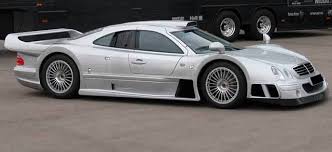

But seriously. I have been wondering about it myself. Back in the eighties and nineties there were a lot of high performance cars on the road with big splitters and wings fitted from stock.
https://encrypted-tbn2.gstatic.com/imag ... 01AR8lk5sw
https://encrypted-tbn1.gstatic.com/imag ... wJRmmeRLNQ
I think the aerodynamically inclined gentlemen on this forum can point tons of reasons why most of these devices are not that effective but that is besides the point. The whole idea of having a supercar is the illusion that it can go fast, despite most of them spending their life revving at traffic lights or in gridlock.
And now the aero has disappeared. That does not make sense. Obviously a wing is needed for real performance as the track versions of these cars have them. So why settle for half the illusion; "my car is incredibly fast except when I have to go around a corner".
The only thing I can think of is that the regulators nowadays do not look kindly on devices which have the potential to convert pedestrians and cyclists to french fries.
So those wings and splitters on f40 and that clk dont work?
