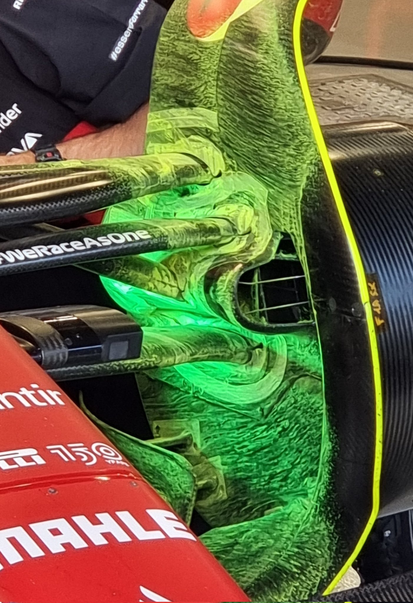

Even better with a taller wheel then, yaw aero, and aero forces have more surface area to act. Even then, things are relative, you can increase the vortex on the side of the tire by aiming airflow at it at an angle. Like my downvoted picture shows, you can aim airflow at an angle you don't necessarily have to depend on the static toe.
The regulations give you plenty of furniture to take advantage of the aero forces on the tire. With a toe out wheel, or angled airflow, that area will get more airflow. The same with the rear end of the car, if you toe out the wheel the furniture on the rear wheels will have a more direct stream of air interacting with it. The flow will be cleaner, and more energetic.
If you toe in the rear wheels you're effectively blocking airflow to the furniture and reducing its effectivness.
Don't take my word for it though, you can try it out for yourself, it's easy to just load up a simulator, crank the toe out and doing some laps. Take your pick, every single simulator you use will show an improvement with rear toe out. You'll think that's just a limitation of the sim physics, but what if it works in the real world?
Re: Suggestions for design undertray
Think about this then, if you have your wheel furniture perfectly working in a straight line, what happens when the car is under yaw? With toe out you ensure the wheel furniture always has airflow even under yaw.
