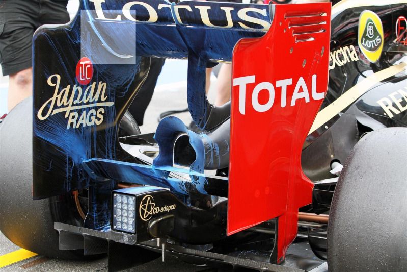

The back end of the DDRS pipe has a peticular shape. Do you guys think it produces some downforce on its own, something like a money seat?

Huntresa wrote:You can have slits in the RW, in the midle 15cm.
Oh, you are right. There is this radius-rule (presumably they put it in to allow pylons in the middle of the wing).
So you can have radii smaller than 10cm in the middle 15cm of the rear wing, i.e. you could make slots there.
But the flowvis pictures show that Lotus is able to stall way more than 15cm and the triangular shape could not stem from "normal" slits in the wing.
turbof1 wrote:The back end of the DDRS pipe has a peticular shape. Do you guys think it produces some downforce on its own, something like a money seat?
You can't have bodywork in front of the rear wing higher than 75cm (that's 15cm above the sidepods). So they can only connect it to the wing in between the endplates.

Huntresa wrote:
but where is the outlet?
In the middle 15 cm of the RW ? Where its legal, we could see on the flowwiz in Germany that something had affected that area.
I seen the flovis pictures and I couldn't see anything, aside from that how would such a system to stall the wing work?
I have no idea, and here is the pic you can clearly see that its a V shape and you got 2 edges forming the V where air or something has blown, Image
That's not being blown it's just the flow separation being caused by the wake of the engine cover periscope.....
Myself, N1ck & Scarbs believe the devices primary purpose is not for stalling / drag reduction but perhaps the opposite giving more DF when DRS is not in use via the lower cooling exit when DRS is activated the additional air is exhausted through the beam wing monkey seat. This will inherently change the rear wings aero profile. I discussed it over on my blog after Hockenheim: http://www.somersf1.blogspot.co.uk/2012 ... nheim.html
In terms of passive stalling of the rear wing I don't buy/subscribe to it as the variables are too large / complicated in terms of circuit characteristics, fuel load etc unless the stalling happens at almost maximum top speed. This could be done by the air switching from the monkey seat exhaust to the periscope, through the bottom wing plane and exiting in the outer channel vents (shown in the picture below) this would help to reduce the load on the outer edges of the wing, cutting the drag.
Have Lotus not also said that this has be born from the same ideals as the Mercedes concept which uses the DRS as the fluidic switch....
386
Joined: 16 May 2011, 15:18
Re: Lotus E20 Renault
That's a massive section of flow seperation from that pylon if it is, I'm not buying that, I still think the vertical slits in the pylon are blowing there to cause the seperation.
