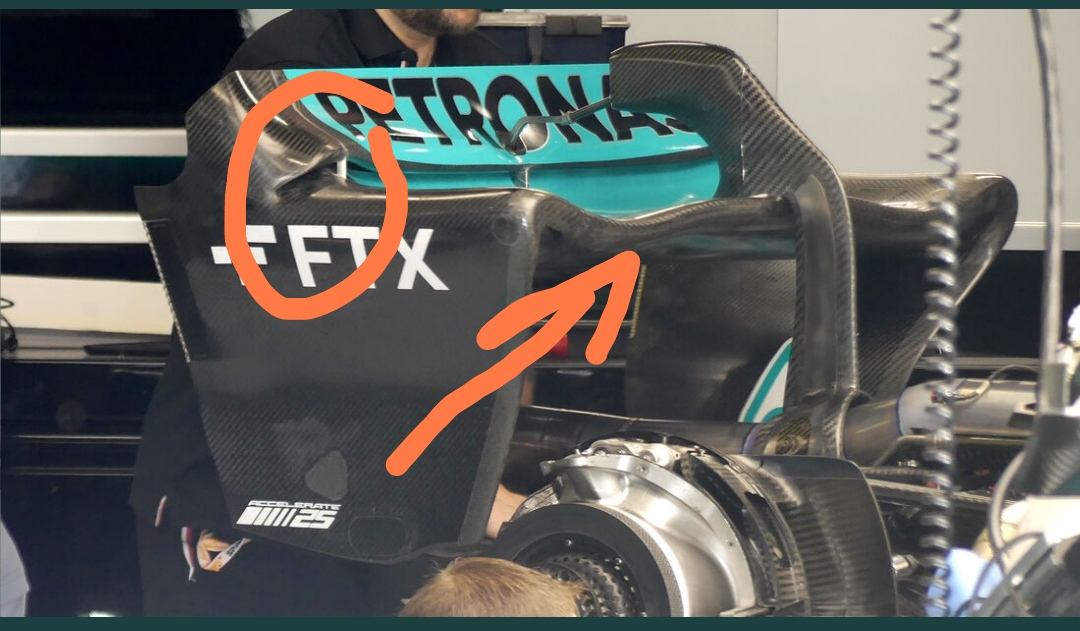

Not a huge change to the floor area but could be that small changes can have large consequences when it comes to porpoising, as we saw in Miami Fri->Sat performance shift
It seems Mercedes' new floor has a significantly taller tunnel height, though the picture is not super clear.
The whole venturi tunnel does seem considerably taller towards the middle of the car, noting the arch of the floor and reduced sidepod depth (assuming the livery application of the silver & green is identical)).
Taller venturi tunnel >> More usable downforce, less peak theoretical downforce? :?:

Looks like the sidepod shape changed slightly in area of the "PET" letters on the Petronas logo.
Yes, it was clever of Mercedes to make the engine cover out of multiple pieces.
The part from below the vent panel down to the floor is new, as it had to be to accommodate the significantly different venturi tunnel height, so it seems they have taken the opportunity to reshape and refine this part of the sidepod.

It's a whole new floor, which is the single largest bodywork part of the car. It doesn't seem they wanted to significantly change the upper bodywork at the same time (too many variables perhaps, or they are confident that micropods are a winner?).
If the taller venturi tunnels are indeed significantly less sensitive to ride height (as you would expect them to be) then that could significantly improve Mercedes' porpoising problem. :)

I'm afraid you're being duped by considerably different angles when it comes tomcomparing the height of the tunnels/middle section of the floor.
If you compare all the screw holes on and around the Petronas logo, you'll see they're all in the exact same location and the floor near the coke bottle area looks higher because of tricky reflections.
The floor definitely seems to have some different profile right around the new flap/edge wing though.

I could be. I bet they have a gap in towards the back to house some stains or structural carbon fibre to increase stiffness of the floor. Notice how the top isn't a smooth surface.

The metal on the floor edge could indicate the possibility of finally adopting metal skates under the floor. Whilst not directly helping bouncing, skates would directly help with bottoming.

The bulge around the E and T letters has gone, so looks like a significant internal repackaging too

I've been fooled before. Re: sidepod bulge, it's probably either lighting or Merc having realigned the sponsor sticker. Other angles don't see to show any change in sidepod configuration.
558
Re: Mercedes W13
The top of the floor is slighlty higher for real. Seeing it from the side angle the floor fasteners are closer to the turquoise stripe.
It could mean a foam layer to make the floor stiffer or a a taller tunnel. Only the engineers and mechanics will know.

They seem to have changed the lower side impact structure's bulge into a small protrusion? only difference i'm seeing on the sidepods :shock:

Mercedes new floor; new Venturi tunnel entrance strakes?
