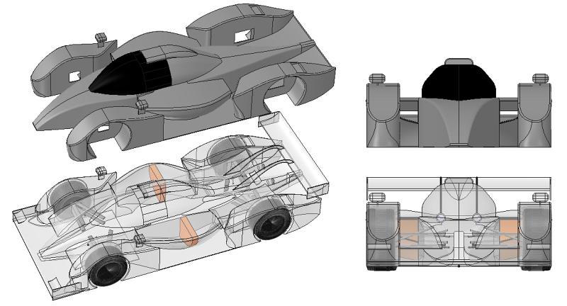

Here we are: the MP004B "open edition" (shortly "MP004C") is ready!
Feel free to download and re-use it or just take a look: the car should be 100% legal, but I can not guarantee that everything is ok. Here are some more details about the package and the links to download it:
http://www.caedevice.net/cfd/car-model- ... ce-mp004c/
I can provide a version without the diffuser, if you have problems editing the very basic one I included.
Don't expect to win the next race without any change: in order to allow to modify it only unsing extrusions I had to simplify many details: anyway, I think the it could have reached 5th place in Monaco.
The staff can freely use it to extract pictures for the rulebook or the website (I don't believe in intellectual property).

This is really great. Thank you Matteo. Maybe this eliminates the need for the intro class car, or it could simply be it. I will talk to Chris.

I think that the diffuser and the front suspension cover should be optimized but I hadn't enough time: if you could run a simulation with WFlow and share the results/postprocessing, I will release an updated version after race 2.

Matteo, thats great once again. I have downloaded every version you release and always take not of the ideas you have.
I might have to use this as a basis for an entry so I can get involved in the next race. Im currently struggling with producing a car like I did when we first went to the LMP style rulebook through a lack of mojo and too many painkillers.

Hi Rick, at the moment (with a more evoluted diffuser) the biggest limit of that car is the lack of front downforce: if you will be able to gain some N on the front axle, without decreasing the cooling flow, you will deserve to stand before my car in the next race :)
