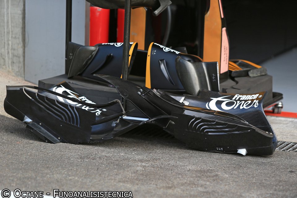

Bottom view of the bargeboards removed from Renault R.S.17

at 1st I thought it was the FW endplates =D>

Interesting direction of development for Renault, they've extended their barge boards inward, thus reducing the amount of air that goes from under the tub to under the floor. Geometry of these extended horizontal pieces now looks like it could produce some downforce just a bit rearward of the leading edge...
