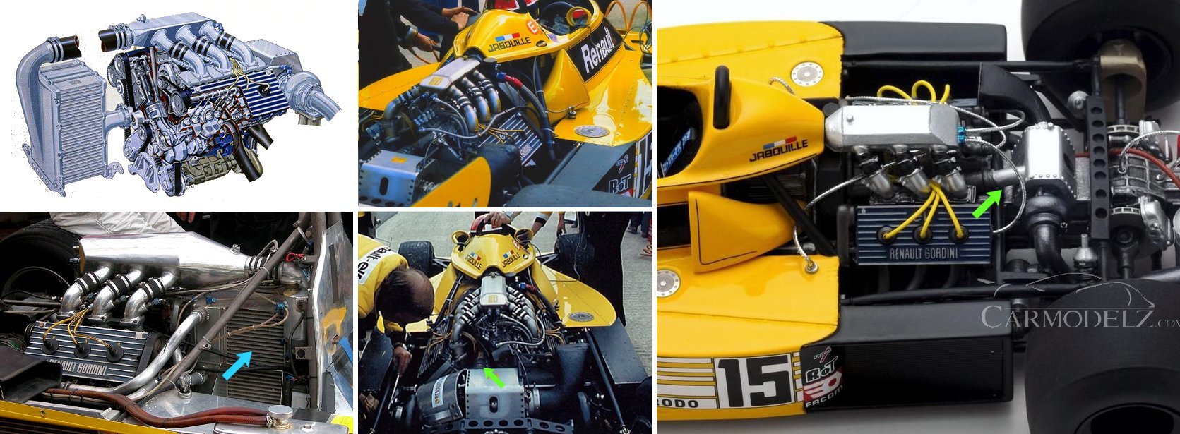

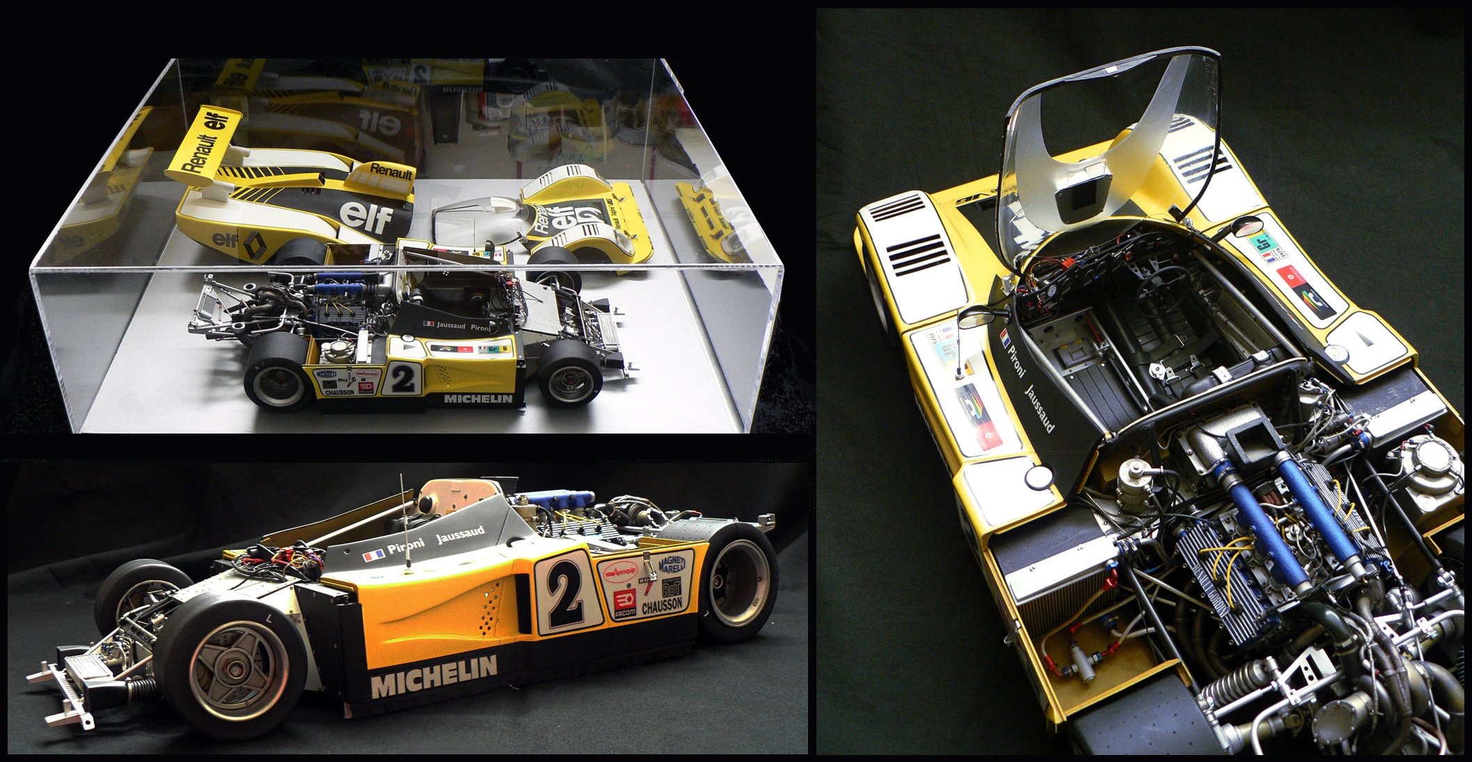

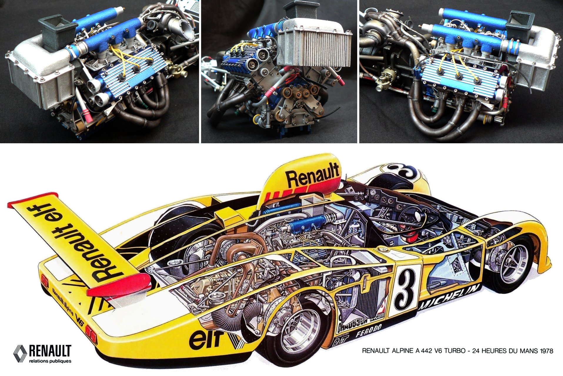

It turns out Renault already used an intercooler placed just in front of the engine, like in 2022, and thus 46 years ago (first air-air, then water-air). So Renault didnt copy this neat layout in '22 from Mercedes or Ferrari, Viry copied it from Viry :mrgreen:
I didnt know that
It was in Renaults first F1, the RS01, which was based on... the Alpine A500
And both inherited it from the Le Mans Alpines
Scratchbuilt model by Builtupmodels https://builtupmodels.fr
Before going for a twin-turbo
