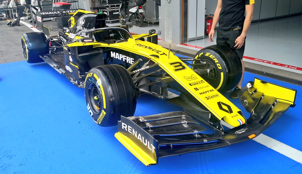

Is that crossways fence on the floor supposed to be there!? :shock: That looks like it would be a disaster for keeping the air attached nicely to the top of the floor!?

Good eye. Might be a protective cover for pressure taps. Some teams run pitot tubes there for testing. Otherwise, hoping for some revo new device.

You're looking at the last boomerang-wing free bargeboard.

What is wrong with this car? Hulkenberg was easily outqualified by the mclarens in Q2 and Daniel out in Q1. This dog needs to be put down.

The picture above your post is everything that is wrong with this car. It's called doing too much for too little. I'm very concerned that the designers here were sipping something exotic.
The whole area is a convoluted mess, and they need to get with the program. There is a reason the top teams are having design convergence in this area. What Renault is doing, is not working.

IMO, it has too much rake and therefore lacks consistent aerodynamic balance in long corners as the front tyre wake affects the underbody downforce production too much when the front wheels are turned (or when the car rolls or pitches), causing a loss of rear downforce in the middle of the corner.
Renault RS19 has the most rake of any 2019 F1 car and IMO this is a mistake. It probably makes good downforce numbers on CFD, but when that downforce cannot be consistently produced throughout a long corner then what's the point of having good theoretical numbers!? :wink:
IMO, the design team has chased impressive peak theoretical downforce numbers instead of chasing solid, consistent downforce production in all conditions.
The car also seems to be flawed on the suspension design with poor braking, poor ride control and poor traction. However the team, to their credit, seem to have improved that a lot between Baku (where it was terrible) and Canada where the car was competent in those areas.
