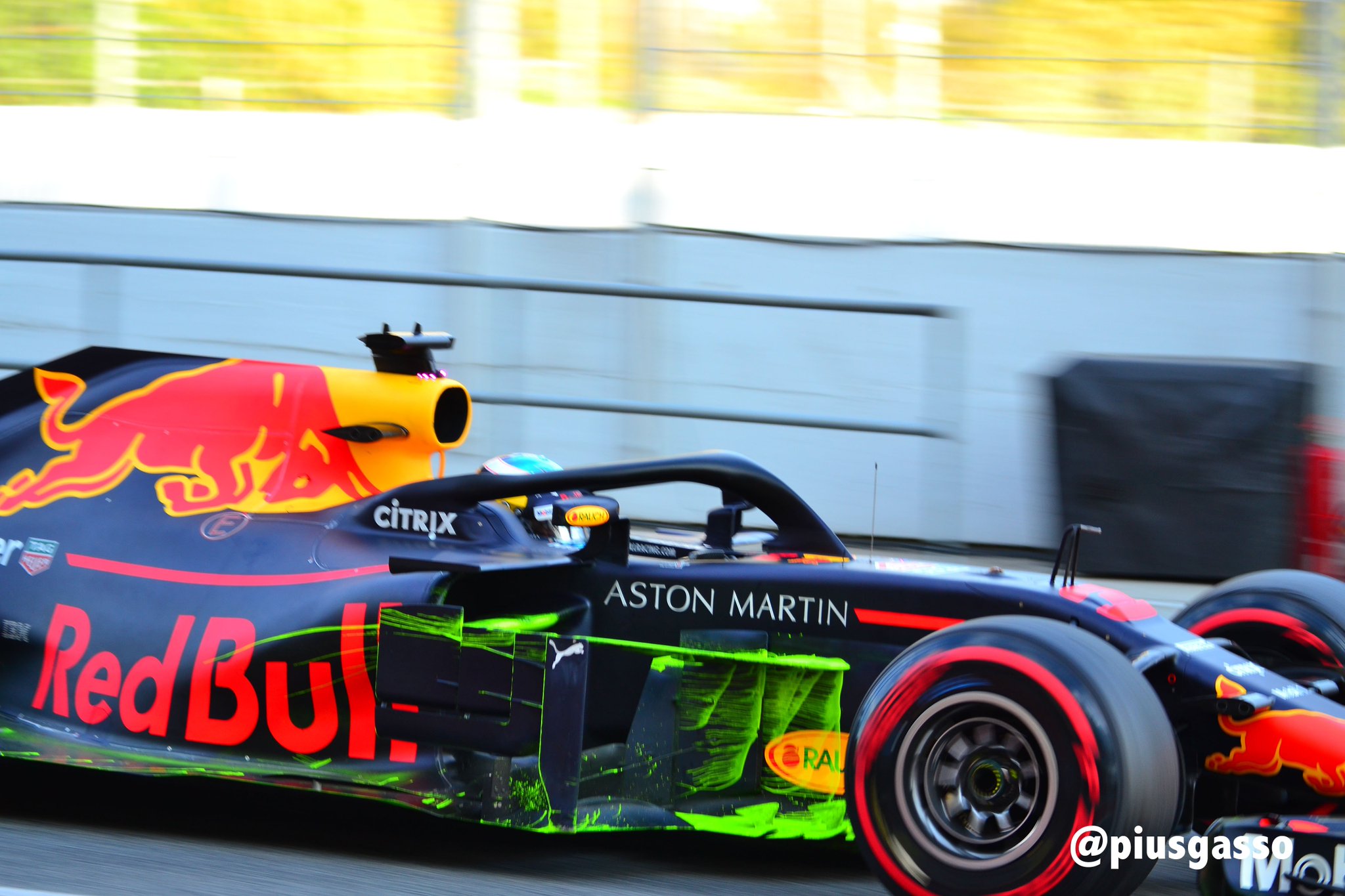

Here you can see where the x wing broke off and how it has been patched and (temporarily?) reinforced very clearly.
