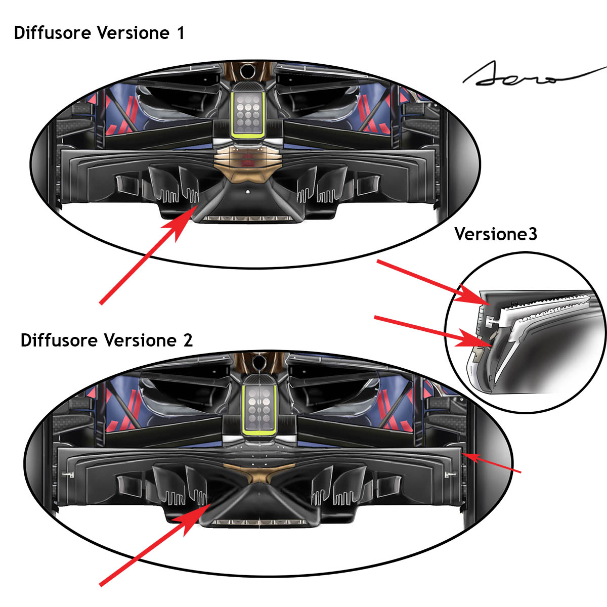

Via @SomersF1
558
Re: Red Bull RB16B
Shark toothed diffuser flaps.
Basically increasing the effective size of the flaps. A bit more drag but should be OK for Monaco.
