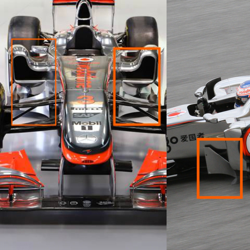

Edith: Image "Papaya" found.

Edith: https://i.postimg.cc/fL4dJ6Lg/IMG-20230325-013524.jpg "Papaya" found.
Interesting reference to the MP4-(2_?) Just continue the waterslide forward; they may, or some other team may eventually if beneficial.
