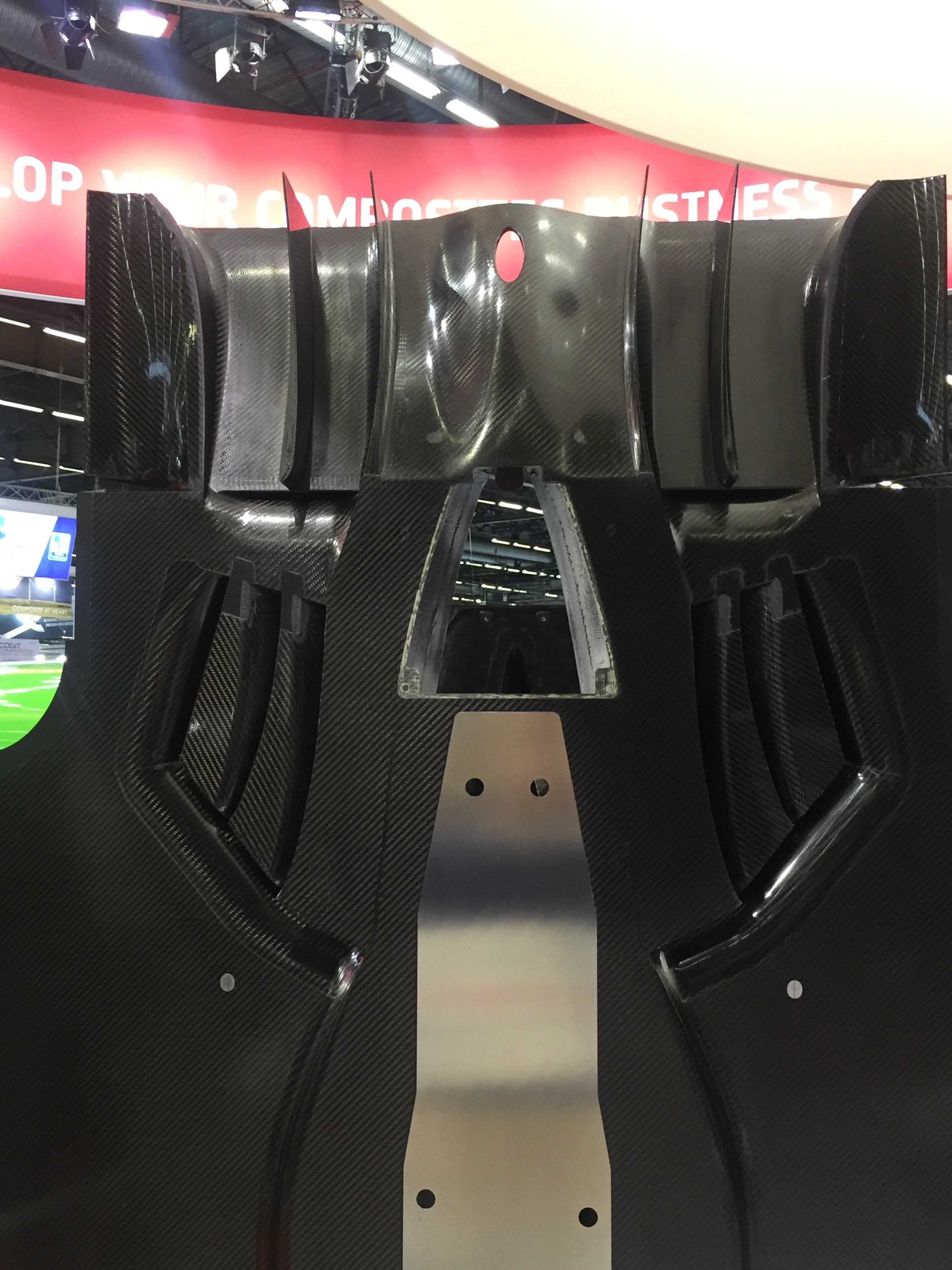

Reigniting an ancient thread for this beauty!! First time I've seen the DDD intake so clearly and from this angle.

Is that a Renault floor?

Just_a_fan wrote:
21 Sep 2021, 17:11
jjn9128 wrote:
21 Sep 2021, 16:46
Toyota
