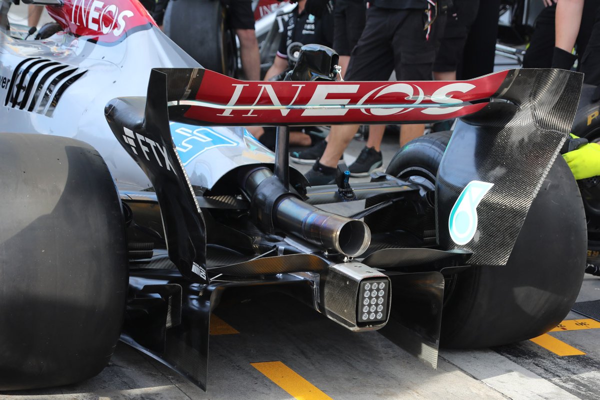

From Piola at Zandvoort:

Re: Mercedes W13
RZS10 wrote:
09 Jun 2022, 23:50
It's just a small winglet hanging down, nothing structural. (= what wogx wrote)
https://i.imgur.com/U5tjl6a.png
https://i.imgur.com/qMTlMYo.png
Another angle:
Also here, and good angle on the FW endplate:
