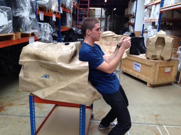

This is how 2014 fuel cell looks like, according to Luiz Razia (@luizrazia) who filmed at ATL for Auto Esporte (Globo TV, Brazil).

techF1LES wrote:This is how 2014 fuel cell looks like, according to Luiz Razia (@luizrazia) who filmed at ATL for Auto Esporte (Globo TV, Brazil).
https://pbs.twimg.com/media/BVaeW6hIEAArjCu.jpg
https://pbs.twimg.com/media/BVbRQBDCQAAU_zu.jpg
https://pbs.twimg.com/media/BVbSNmGCQAIU56_.jpg
Is it me or it looks bigger than 2010-2013 tanks? space for oil tank looks bigger too. Does it have space to host the ERS batteries underneath it?
