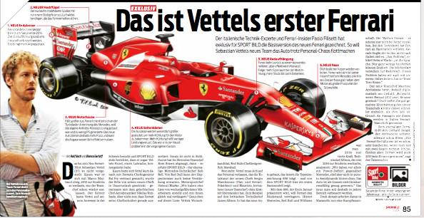

mikeerfol wrote:
Can I ask where did you find this?
You can find it here
https://twitter.com/bgarloff
By Bianca Garloff AUTO BILD MOTORSPORT draw by Paolo Filisetti
For me nose is illegal too short
But a draw so 'small is difficult to judge

Those mid waist hot air exhausts are a design feature that fry brought over from mclaren. I don't think those will be on the new car. It has characterized all the ferrari f1s under fry, and i always saw it as some aerodynamically neutral philosophy he was pushing. It cleared up the floor of the car, while not creating lift due to it's shape. However it still occupied space in the middle of the car and must have some downstream effects on the air flow.

@ringo
I agree. And than still, those were modified on F14-T mid-season to extend through rear suspension components influenced by Mercedes' design.

I think apart from Nose every thing will be changed massively at front not too sure about rear though

Merc's "u" nose is illegal in 015 so I doubt that's a valid direction. Going split turbo and log exhaust should allow smaller top body? I know Ferrari will require larger cooling in 015 and thus side pods will be bigger
