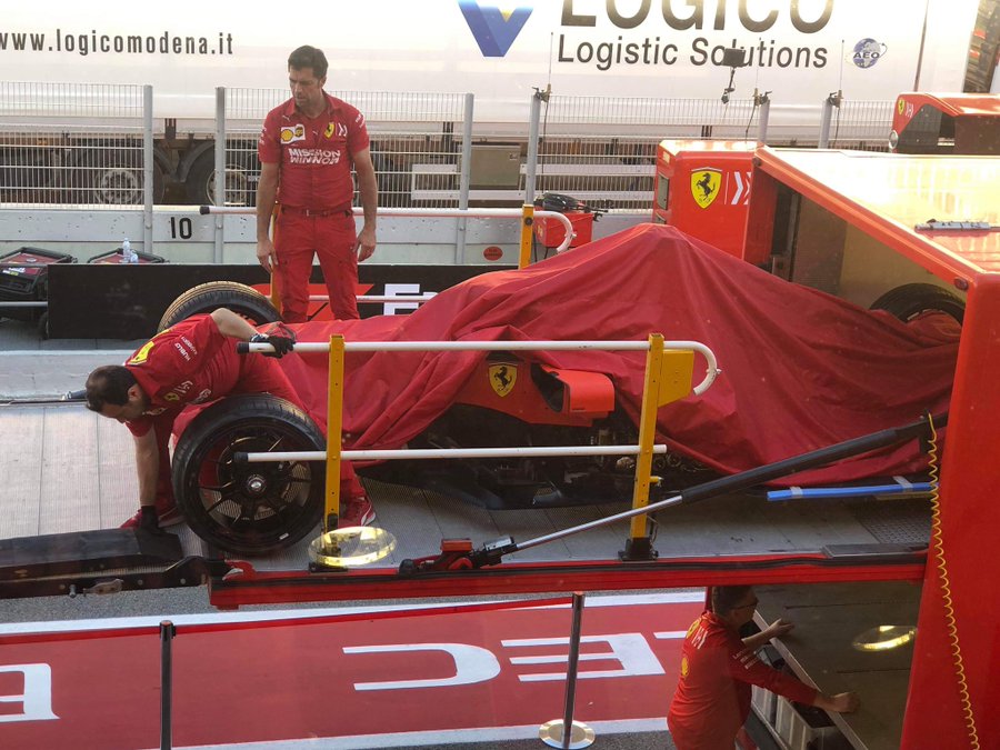

Those are probably just to transport the car

Re: 18-inch wheels to be introduced in 2021.
I think it looks better than the ridiculous balloons we have today.
also, I think that any F1 teams that have close ties with any series that run 18 wheels already will have an initial advantage when they come in. *cough* Ferrari *cough*
