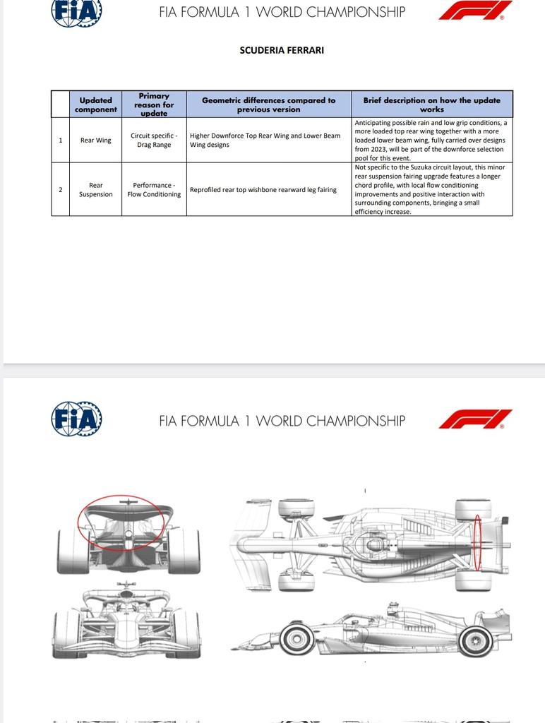

Re: Ferrari SF-24
https://formu1a-uno.translate.goog/it/f ... r_pto=wapp
Posting this article here as well.
In Japan, what will be an updated fairing of the upper triangle of the rear suspension will be previewed. A fine modification, purely for aerodynamic purposes, like the small wing profile that appeared on the SF-24 in Melbourne, which will serve to manage the flow between the inside of the wheel and the bodywork in a different way, in a very important area of ​​these new generation single-seaters

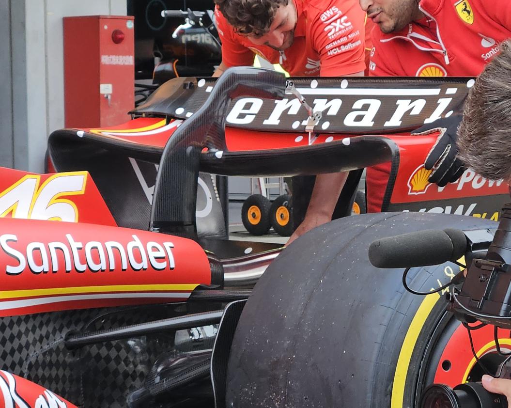

Re: Ferrari SF-24
Rear wing
Re: Ferrari SF-24
Same old wing.
Will they go for double beam wing in Suzuka?
Doesn't seem like a good option to bet on DRS effectiveness at a track with one zone, but maybe the drag reduction pays for itself.

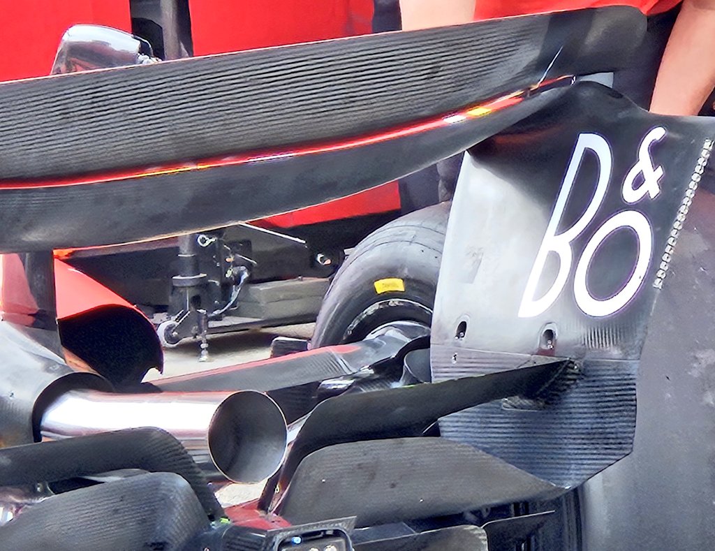

Re: Ferrari SF-24
SF-24 Japanese GP 2024

Re: Ferrari SF-24
Sevach wrote:
04 Apr 2024, 04:50
Same old wing.
Am I following this correctly, in that the SF-24 has used the same rear wing on all 3 previous races and now again?
That's quite remarkable considering how different each track is.
falonso81
Joined: 04 Sep 2013, 15:29
Re: Ferrari SF-24
Waz wrote:
04 Apr 2024, 10:57
Sevach wrote:
04 Apr 2024, 04:50
Same old wing.
I believe that is the case. Only difference is that they are using a double beam wing here.
1802
Re: Ferrari SF-24
Waz wrote:
04 Apr 2024, 10:57
Yes they did use it and will use the same rear wing again in Japan. They changed beam wing specs, but it was quite clear they made a mistake not to use smaller rear wing in Jeddah after Q, where they lost 5 tenths on straights to RB. They were also losing 4-5 tenths on straights compared to RB in the race, every lap. Better tyre deg was never going to offset this.
We will also likely see the same rear wing in China and I honestly hope they will finally use low drag wing in Miami.

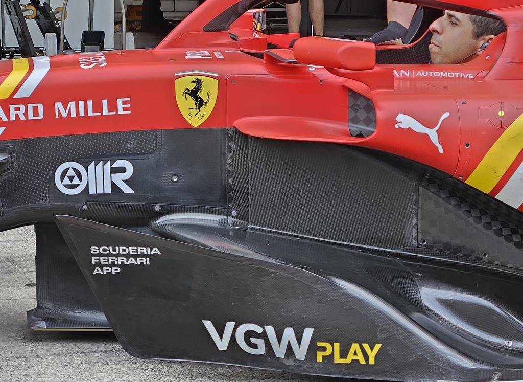

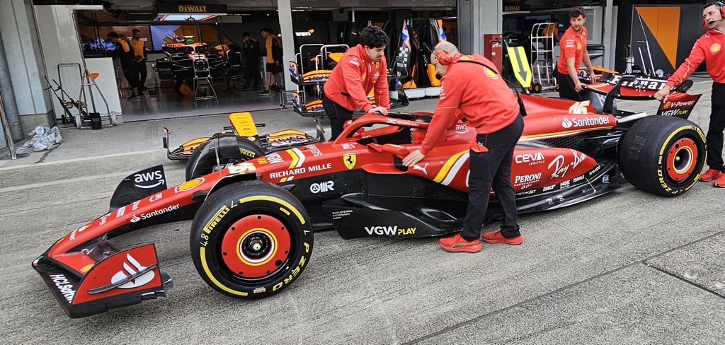

583
Joined: 12 Feb 2013, 12:46
Re: Ferrari SF-24
From these photos it doesn't look like there are any updates on the suspension arms, let's wait for better photos anyway #Techf1 #Ferrari #JapaneseGP

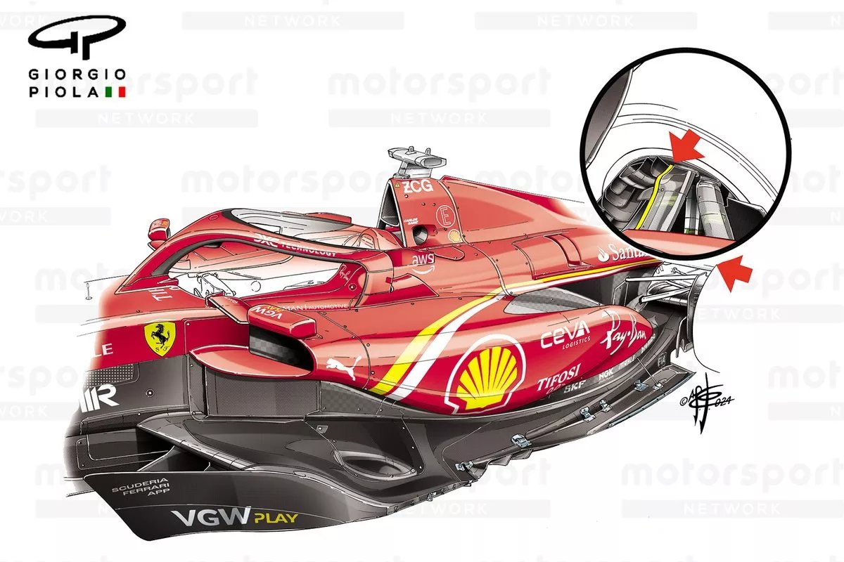

Re: Ferrari SF-24
JPBD1990
JPBD1990
51
Joined: 22 Feb 2018, 12:19
Re: Ferrari SF-24
Interesting, but is this new? I’m still unclear on that.
dialtone
dialtone
139
Joined: 25 Feb 2019, 01:31
Re: Ferrari SF-24
Not new. Been there a while.
