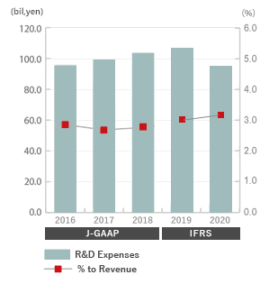

just to provide some context, to some information's which where mentioned in the video and what ties in with what JT said earlier in this thread.
MICHELIN
Michelin allocates significant financial and human resources to research and development: R&D has a budget of over 500 million euros p.a. and employs over 6,000 people worldwide.
BRIDGESTONE
Research and development expenditures for the tire segment in 2006 totaled ¥71.5 billion ($600 million).
compared with PIRELLI
1,200 full-time researchers globally
R&D estimated at ~117 Million Euro p.a. (see below)
2012 Update
Investments for the year 2012 are seen at below 500 million euro (prior target approximately 500 million euro) and will be predominantly destined to the expansion of Premium capacity, and quality and mix improvements.
they don't quote a direct number for their R&D budget (7% of TO), but as you can see, their total investment volume/budget is equal or slightly smaller then what Michelin invests in R&D alone. From here you can see, that they claim a total investment in R&D of 350 Million Euro for 2013-2015 ( ~117 Million Euro p.a.)
