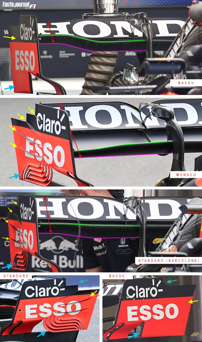

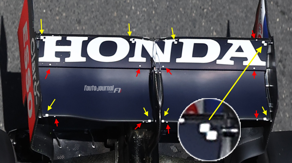

Comparison of last races RW-configurations:
Although the above "red arrow comparison" is a bit influenced by camera angle as we can see here in the top-shot from Baku's RW:
Via @NicolasF1i
seense
seense
Joined: 09 May 2019, 11:36
Re: Red Bull RB16B
They didn't run the first RW in Baku during race. The last RW is just a different version and that's the one they ran in the race. That has nothing to do with camera angle I believe.

Re: Red Bull RB16B
280
Joined: 06 Apr 2014, 10:49
Re: Red Bull RB16B
In France, PER again used an old-spec front wing while VER used the new one (including Monaco and Baku upgrades). Third race in a row where PER using older spec than VER.
