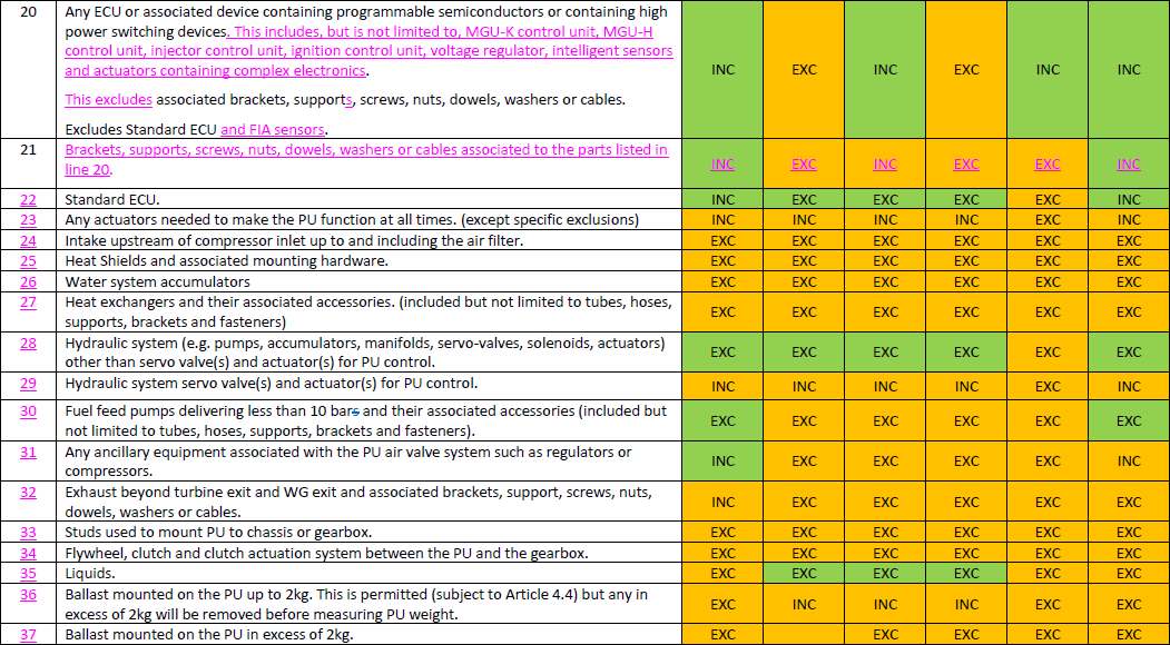

APPENDIX 2
POWER UNIT SYSTEMS, FUNCTIONS AND COMPONENTS
- updated, see previous version of regulations: v2013-07-08 (page 83)
