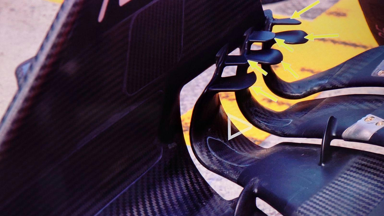

Minimal fw change?, they completely redesigned maybe the most crtical area of the fw nowadays,

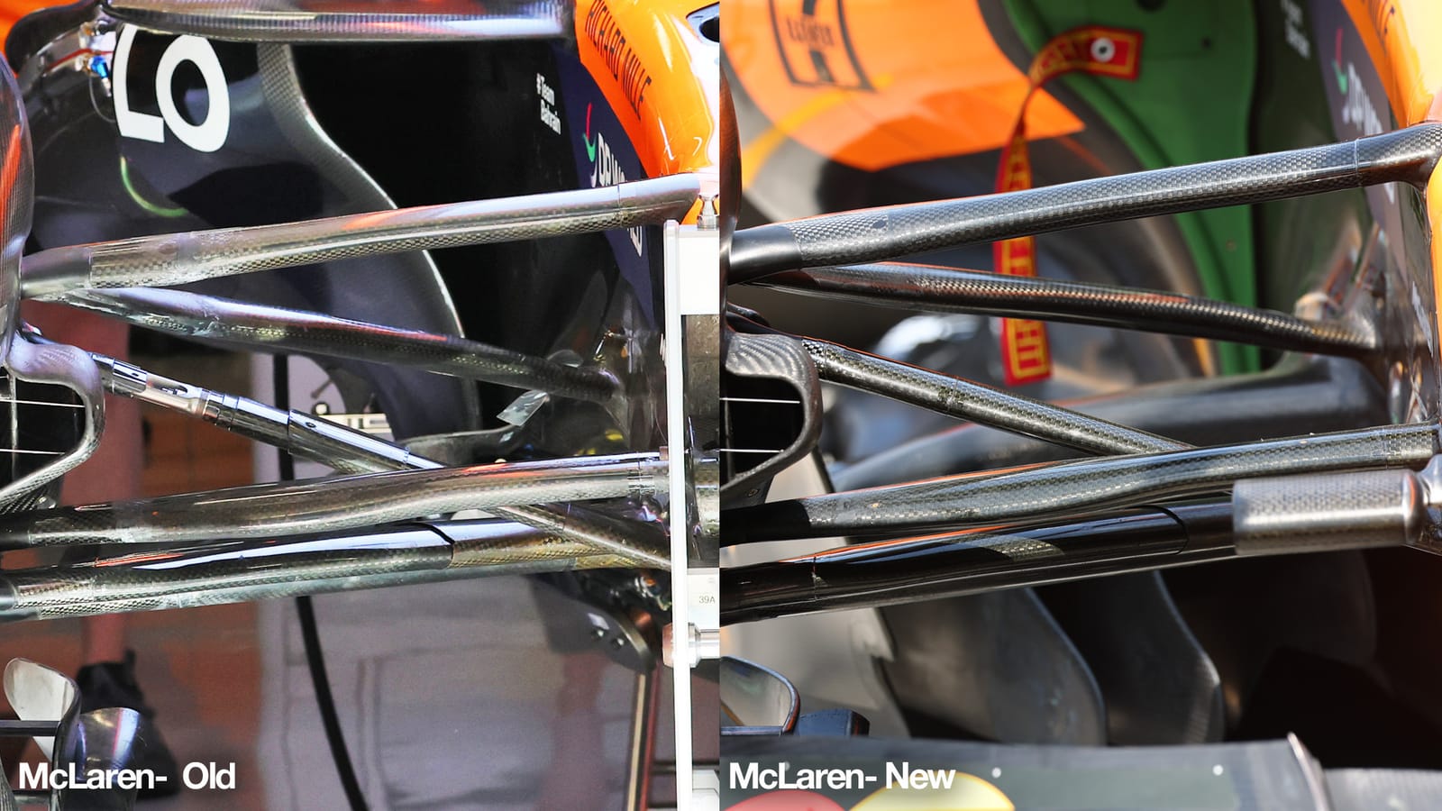

Front suspension an attempt to resolve the numb feeling at the front of the car. Pics from the race.

f1rules wrote:
14 Jun 2025, 00:06
Updates to endplate VGs are very low yield now, well under 1 tenth. Bigger impact is poor flap angle by several clicks, let alone flap and wing designs by themselves

mwillems wrote:
14 Jun 2025, 07:17
https://www.the-race.com/content/images ... canada.jpg
https://www.the-race.com/formula-1/land ... ren-issue/
What is the significance that on one of the shrouds, the telescopic layers have been removed to leave what appears to be now a normal shroud that won't stretch or shrink?
Am I reading too much into this, or was something happening that was preventing forces reaching the car and possibly stopping horizontal forces from disturbing the tyres contact with the road, that has now been removed, or at least move elsewhere out of sight?

mwillems wrote:
14 Jun 2025, 10:27
mwillems wrote:
14 Jun 2025, 07:17
If I understand from your description correctly .... the two differ there because one has the "aero" skin moved out of the way to facilitate adjustment (it's the active pull rod ) in which they alter the length, hence ride height, by exchange of shim stack in that link to facilitate setup. Usually in operation it will have that cover/sheath in place such that the adjustment point is not visible.
You can also see on lowest link in image that there's vertical separation/joint in the sheath to make telescopic movement possible as that's the steering arm which needs to change in length for turning the wheel upright when lock is applied via steering wheel. Effectively they call this "track rod" in general description.

Farnborough wrote:
14 Jun 2025, 10:56
mwillems wrote:
14 Jun 2025, 10:27
mwillems wrote:
14 Jun 2025, 07:17
Ahh OK, so the picture on the left is an outlier in that normally you would not see that telescopic sheath and this is not suggesting they are doing anything differently here?

Yes, correct.
Completely routine to see it as that left image during setup as they will be putting in place the desired starting dimension to their specification, or making adjustment if needed between sessions. This to alter the static ride height on demand.

But changes in this area has probably all to do with optimization downstream, floor seeling etc. and almost nothing to do fw characteristics, but must be amazing that you can quantify so precisely ;-)
Vanja #66 wrote:
14 Jun 2025, 10:20
f1rules wrote:
14 Jun 2025, 00:06

Are the race dead serious, they show an old picture where the carbon cover has been removed, pushed down for they can adjust :-) It doesnt look like that all the time lol, these so called journalists, some times :-)

f1rules wrote:
14 Jun 2025, 12:18
https://www.the-race.com/content/images ... mage1.jpeg
Well yeah, to an amateur like me I assumed like for like and thought there was something in it!
But I got to learn something about track rods and their setup thanks to Farnborough :lol:
