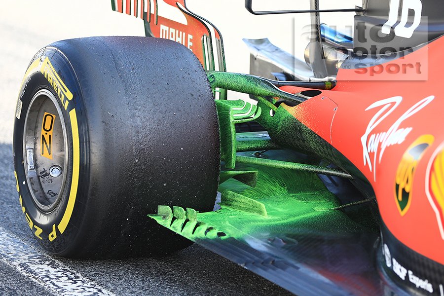

The rear rim seem to have a threaded plug in the lip. Could it be that it unscrewed from vibrations?
For Sure!!

Re: Scuderia Ferrari SF90
Via AMuS

what are those big fat "inbus" bolts in the rims?
