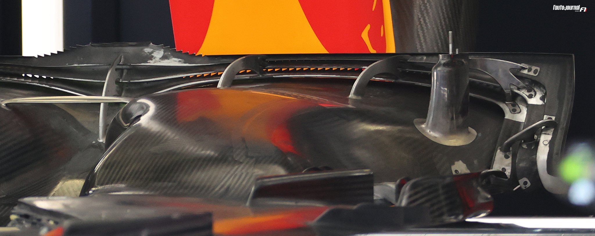

Shark Teeth
via @NicolasF1i

Awesome perspective.

Nice photo!
Very interesting how they are shaping the outer edge of the diffuser, it almost looks like a bell-mouth (which would be good for airflow); I just need to work out whether that is to allow a sideways flow into the diffuser - potentially taking advantage of tyre squirt turbulence, or allow easier extraction of the tyre squirt turbulence by the rear hub aero detailing?
I wonder what others are doing in that area?

Amazing how well and finely the metal bonds to the carbon fibre.

complex 3d shape manufacturing in all sorts of materials to a very high ptecision is the big advance in production and fabrication ,apart from parametric 3d Cad of course .
So you can go for those marginal gains of complex 3d shapes because you can !

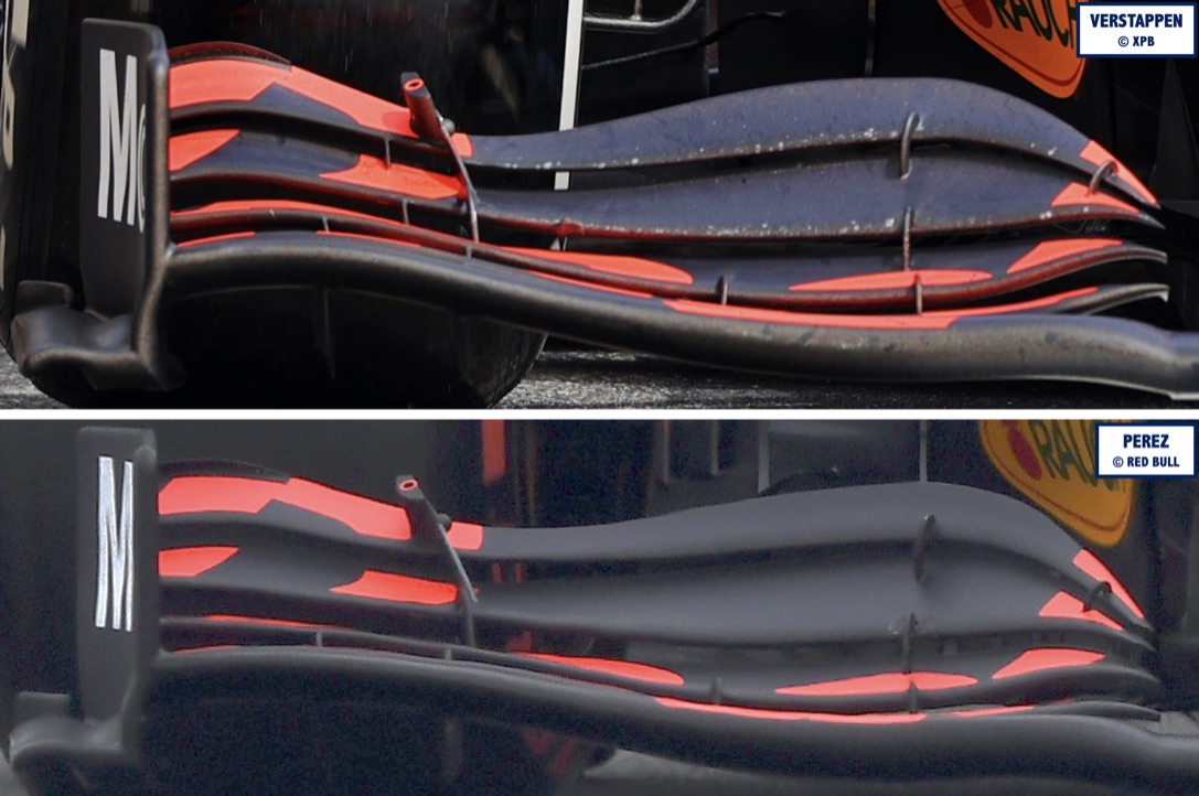

The air coming off the diffuser edge and tire squirt collide raising the static pressure behind the tire. Higher static pressure behind the tire causes lower pressure difference between leading and trailing edge. This weakens tire squirt.
Wheel alignment is important when it comes to aero because the wheels are big and the alignment can change the angle by as much as 25mm at either extreme. The strakes, endplate and outer section of the front wing affect airflow to the tire. Red Bull are the best team at aero because they knew this since 2019.
They made their front wing outboard loaded, the only team to use that configuration since the 2019 front wings were introduced.
Now that they have the rear end sorted, they have a really nicely balanced car.

What is the actual difference between one wing and the other (VER vs. PER)? I don't see it.
