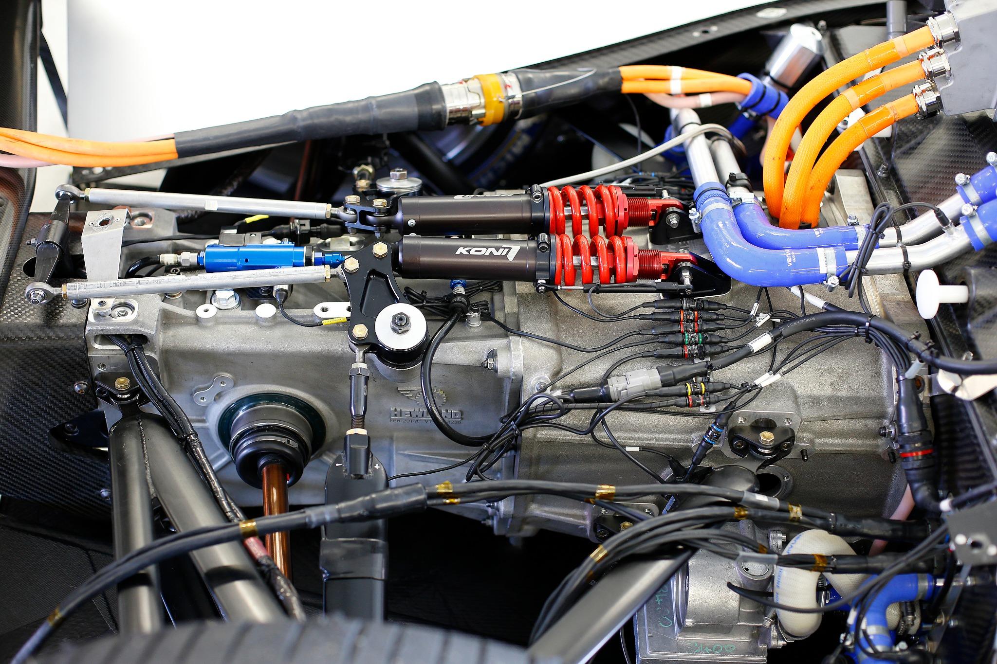

Re: Formula E
Here is a nice picture of what the car looks like without the all the cover.
FW17
169
Joined: 06 Jan 2010, 10:56
Re: Formula E
stefan_ wrote:Here is a great picture of what the car looks like without the all the cover.
https://pbs.twimg.com/media/BxL5nD_CIAAUzxf.jpg:large
What is the greatness we are looking at?
The fact that the rear does not have a heave spring?
Or the giant dampers?
Poor packaging?
Wheel teethers duct taped to the wishbone?
Re: Formula E
I replaced "great" with "nice". Better now ? :)

stefan_ wrote:Here is a nice picture of what the car looks like without the all the cover.
Thanks, it's great to see some hardware at last. I hope they have an open garage door policy similar to F1 so we can see more of the cars over the weekend.

Re: Formula E
Similar pic, but showing even more:-
